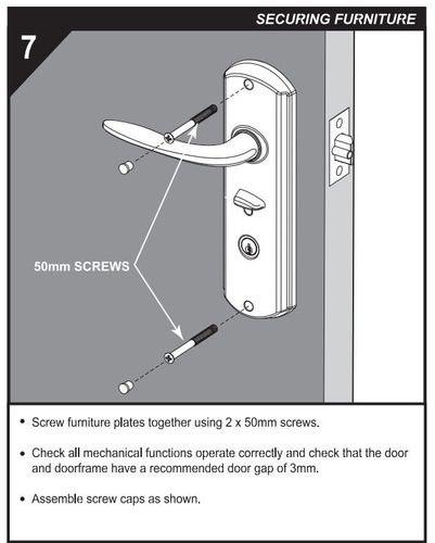

That looks like a LOCKWOOD NEXION MECHANICAL handle set.
To jog my memory I found the Installation Instructions and Template.pdf on the Lockwood website.
The screw caps are more like plugs.

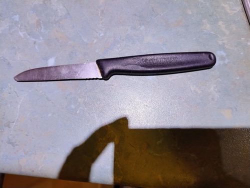

Anytime I have to remove caps like GPO's or even the back of a watch I have two small kitchen knives in my travel tool kit.
Looks like this.
That's a kitchen knife and boss lady still not happy I broke the tip.
I found a $2 shop that had them and bought a box of 10.
The broken tip actually works better than the original pointy one.
Try using two knives similar to that and if needed squirt of RP7/CRC.
If no-go heat the screw areas with hair dryer and chill the screw cap with freeze spray and (no pun intended) pry again.
