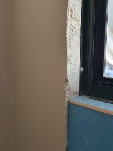

Good afternoon,
We have recently had new aluminium windows installed and needing to render around internally.
There are no architraves.
How do you suggest we move forward with the rendering?.
Can we render over the aluminium bit that is attached to the brick wall?.
Thickness of rendering.
Can we use ready made render?
If so, which do you recommend?
Also, should the blue board allign with existing brick wall?.
Thank you very much in advance.

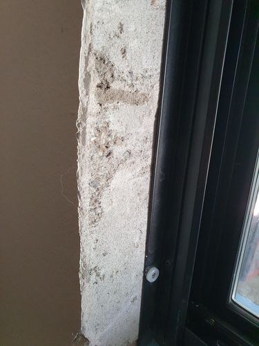

I am unsure if you were able to see the photos that I attached of the installed windows?
What do you suggest that I do then if we cannot render over the aluminium?.
We are unable to add reveals now unfortunately as it will affect the lock or closing mechanism piece.

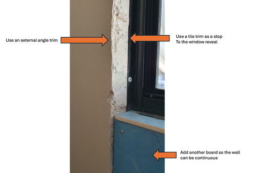

Hi @anna123
I would consider doubling up on the facing blue-board so the wall was continuous flat across the face. Then use an angled trim on the corner edge to increase strength and provide a straight edged line. And maybe something like a tile trim to finish the render up to the window reveal.

Hi @anna123
Those are excellent suggestions from @Nailbag. I totally agree with the suggestion of using the trims to get a uniform finish on the wall, I propose going to the store and examining the trims that you can use on your wall. Adding a second layer to the blueboard is a quick solution when you have uneven walls. The only other thing I can add to the recommendations made is to make sure that you have all the parts you need before you begin to render.

Good Morning @anna123

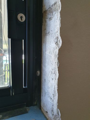

I like @Nailbag's suggestion tho not sure if the sill itself will work out with your locking mechanisim?
Any chance of a photo to show the window as a whole and also one of the sill and lock?

Re: How to render around internal windows?
Thank you so much for your suggestions and adding to the photo, that is super helpful.
The plan is actually to have plantation shutters installed as well.
Would a super thin trim be a good idea?.
If you zoom in on the screw they have used a plastic 'thing' have been used when putting the screw in. Perhaps we can remove that?.
I am worried that if we render, the window will rust?
