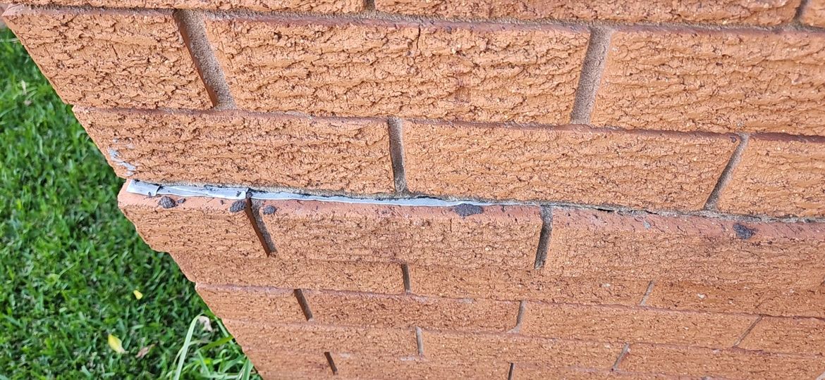

I am looking to render my old house, I have watched vedios on bunnings website and youtube. I tried my hand on couple of the wall inside the garage and was able to get the satisfactory finish. However outside the home is a different ball game. It has windows and damp course.
My question is

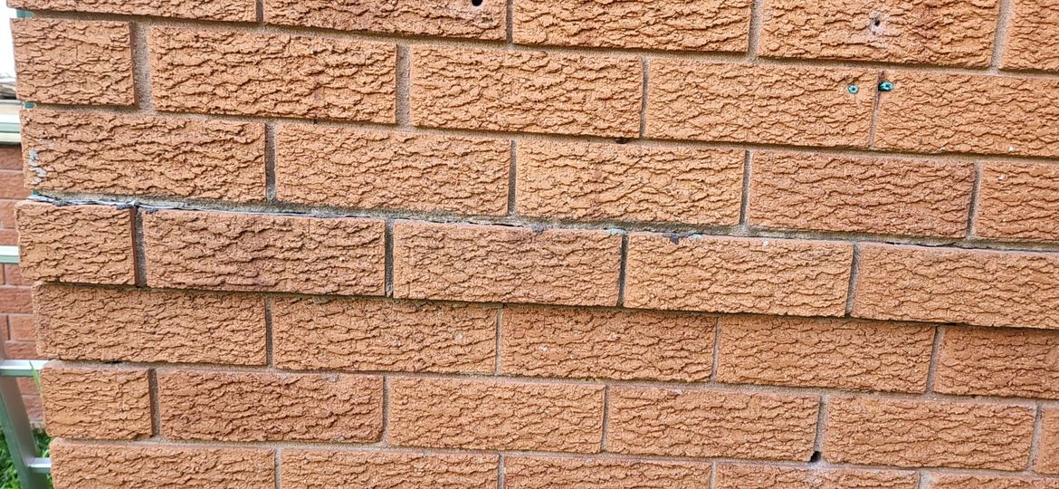

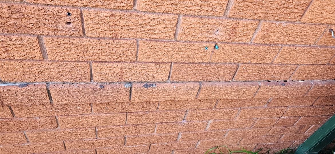

1. How you render over the damp course. I have a layer of brick which protuding a bit from the main wall, I am assuming its damp course layer. This layer of brick is atleast 15mm out from the main brick wall. Should i just render above this layer? what are my choices if i wish to render whole wall above damp course and below.
