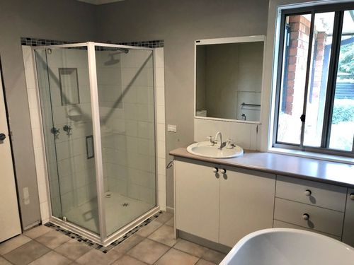

Hi there,
Looking at updating the bathroom, toilet and laundry space from the 80's vibe they currently have.
The space of each room is quite small, wondering what potential options would suit best.
1. Keep each room as separate
2. Combine toilet and Bathroom
3. Combine toilet and Laundry
4. Combine toilet, Bathroom and Laundry
It all just feels very tight at the moment, so hoping to make it feel abit bigger. any ideas welcome!

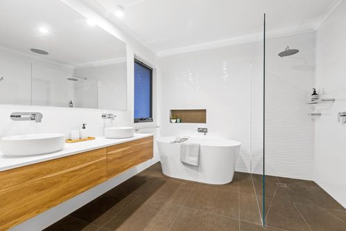

I 100% agree with @EricL and go with Opt 2 and leave the laundry as is. It's amazing how much additional space you will gain once that dividing wall is gone. below is my last bathroom reno so you can see the change you can make with better use of space.
