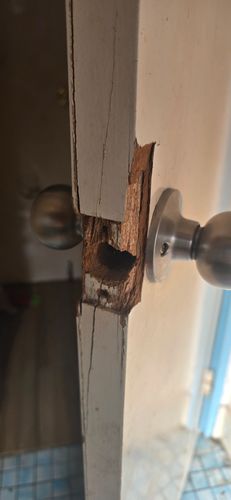

Is it possible to repair this hollow core bathroom door? Had to break it down as kid locked themselves in.

While it would likely be possible to repair the door, it isn't really practical when you consider the difficulty and cost of repairing the door, with the difficulty and cost of installing a new hollow core door like this 720 x 2040 x 35mm Internal Door.
To repair it, you would need to cut out the damaged lock block, cut a piece of timber to replace it, install it, cut thin MDF to replace the veneer on the door, fix and glue it all back together, patch any seams between the new MDF and old then redrill the holes for the lock, and reinstall the hardware before painting.
If you replace the door, you will just need to remove and reinstall the hinges and doorknob to the new door and maybe trim the door a little bit. You could use the old door as a template for the new one and use this Ryobi Wood And Metal Door Lock Kit to make the lock installation simple.
