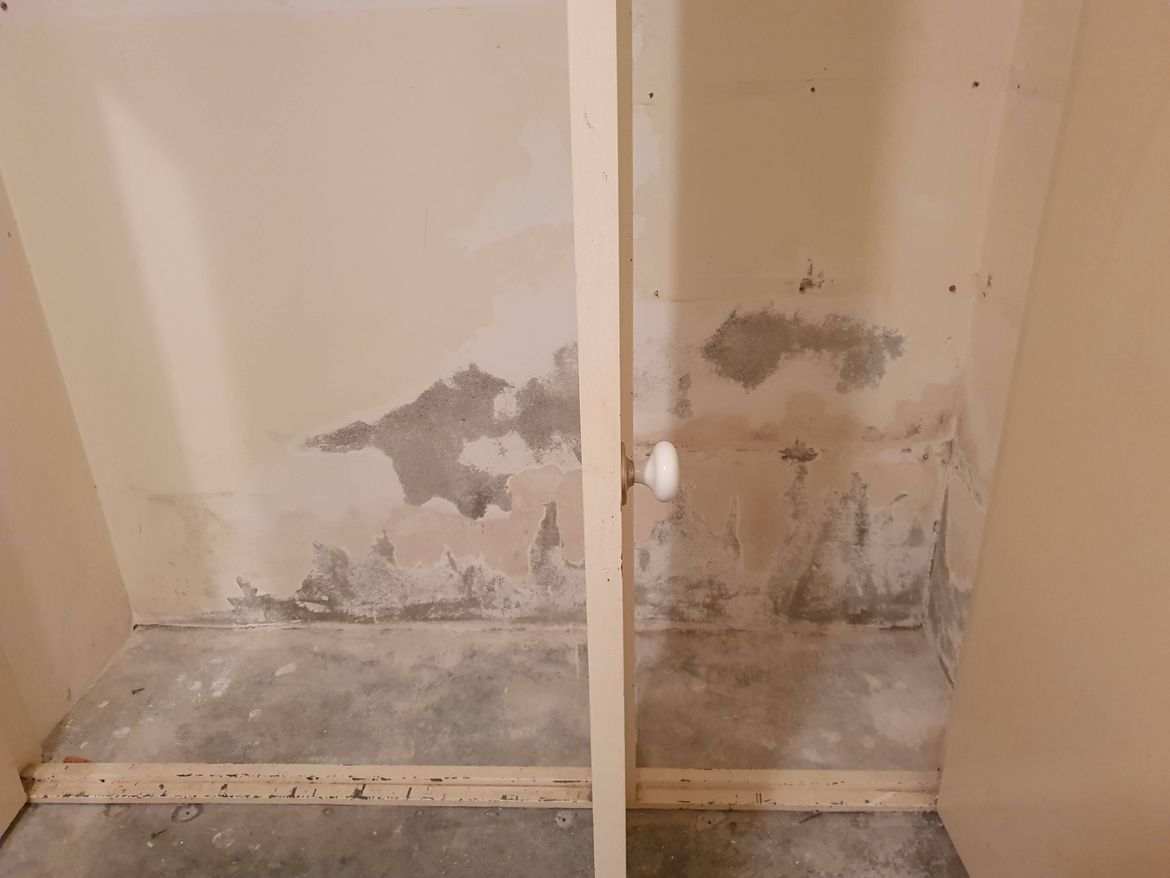

I've just bought a 40 year old brick home with walls that needs some TLC.
They're dirty, chipped, cracked, dented, and a couple have water damage.
For the water damaged sections I scraped off the soft plaster/ white set and sealed the cement render with Bondall, before applying white set and smoothing with Gyprock Easy Flow.
Hopefully that was the right approach?
I was just going to prime and paint these areas the same as everywhere else.

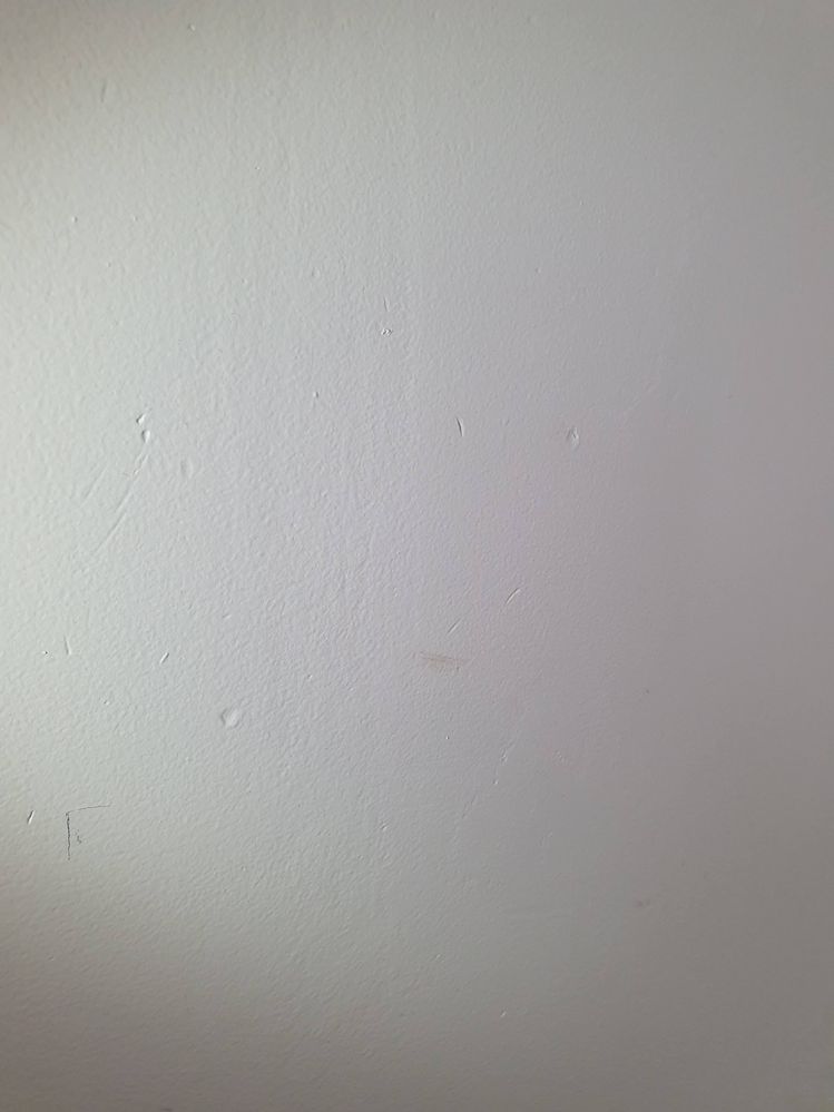

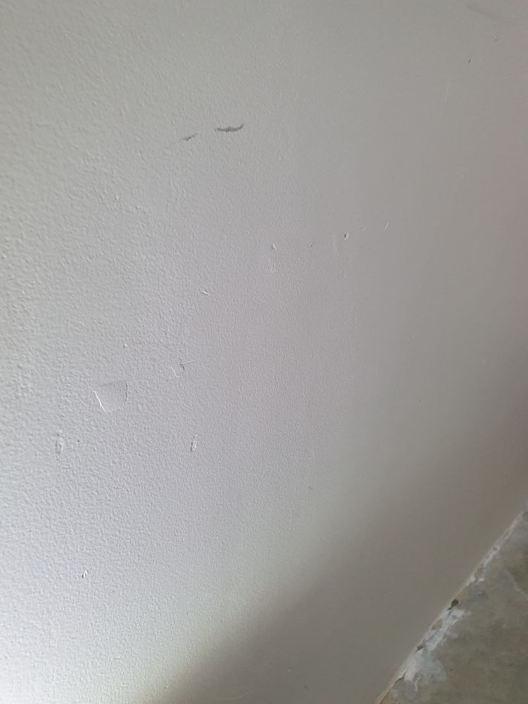

For all the chips, cracks, and dents, I keep going in circles of patching, sanding, see more imperfections, patching, sanding etc.
Now the walls look like a leopard print. I'm concerned that when I prime and paint (with an airless sprayer which I've not used before) all those patches will show through, given the texture difference.
Apart from back-rolling after spraying each coat, is there anything else I could do to avoid this?

You look to be on the right track and just need some reassurance that what you are doing is correct, which it absolutely is.
The approach you have taken to the water damaged areas is perfect and exactly what I would've advised.
With the chips, cracks and dents, the process of patching and sanding is still the way to go. Once you have applied the primer, you should find that a lot of the more minor imperfections are smoothed and filled and once the paint is applied to the whole wall, the texture will be far more uniform.

More sanding, larger smooth areas with plaster was the answer. I was thinking smaller plaster  patches so less to actuall sand but this is counterintrusive. Main aim is to get that smooth surface without feeling bumps or seeing them. Once I started to trully use that wide trowel you have the easier it all became.

Hi @Duffman I agree with @JacobZ and stick to localised filling and sanding all the dents and scraping off the lumps.
If you haven't used a spray gun before, it's definitely not a magic tool to cover the imperfections. It's more a tool that speeds the process up and then you have to know what you're doing, and that takes practice. If you go down the road of skim coating entire walls, then I would also recommend the Rocket Giant sanding tool @JacobZ recommended over the powered one. I've use or should I say attempted to use non pro-versions and you can very quickly do a lot more damage than you started with. Plus you also need a decent workshop vacuum to attach it to, which you will need if not already in any case.
I would be doubling up on the Dulux 1-prep and using a something like a 15nap quality roller. And the more matt the final paint the more forgiving of those imperfections.
