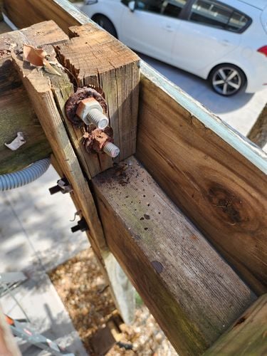

Hey team, I have a 265 x 65 bearer that spans 5.4m on a balcony in front of my house. The bearer itself started to split so purchased some replacement timber. Currently the bearer is connected to the post with a VERY precarious looking notch that is bolted to the bearer. I was looking at doing a flat connection for the post to the bearer but I don't seem Australia using the Simpson strong tie brackets. So with the hardware available here, what would be the suggested way to connect the bearer to post?
