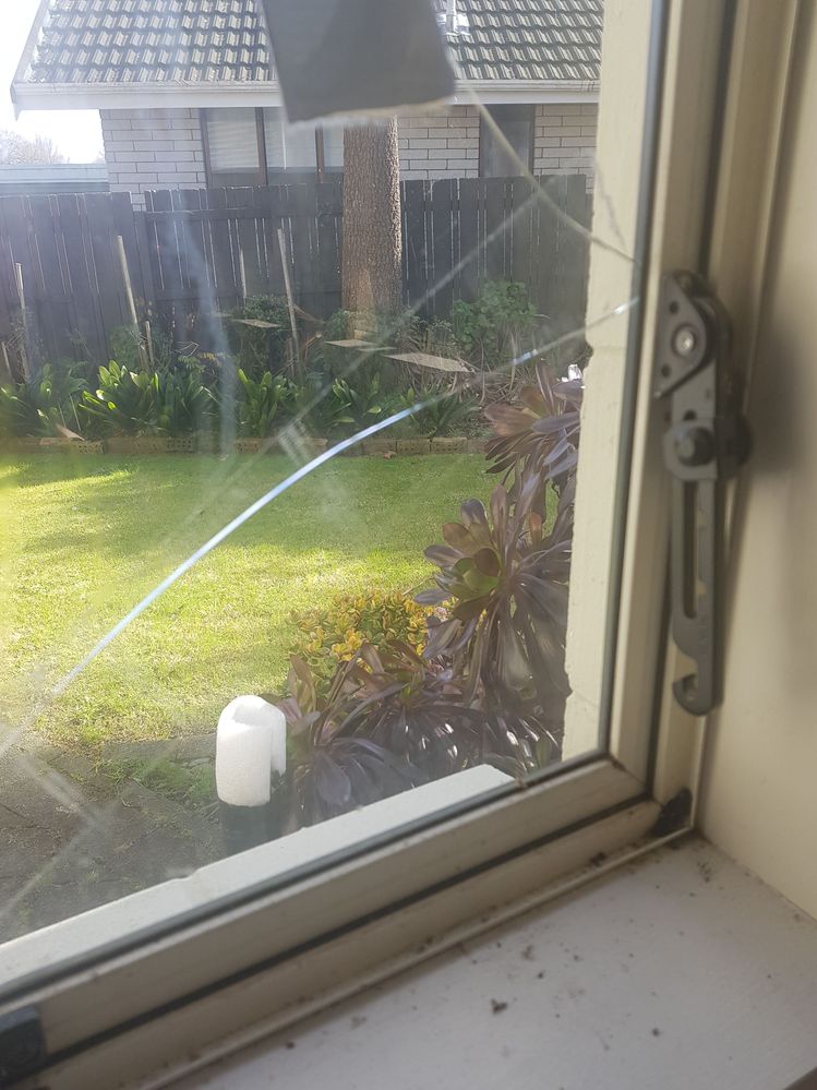

Hi guys, I tried to do a repair of broken handles on windows on aluminium joinery to rivet them on but when I pre drilled the holes I cracked the glass. Is this because I went in too far? Any help appreciated. TIA

Thanks, sorry for the slow reply. Ended up taking the pics of the side rail one's that cracked when drilling. I used a small bit but obviously hit the pane. Any info on these aluminium panes for future awareness would be appreciated.

Yeah like you said it looks like you have drilled into the pane of glass. If you were going to drill another someday I wouldnt go any closer to the edge then what the holes are for the original handle. I would say there are very close tolerances in the manufacture of windows. (So if you go straight up in the same line as the original holes then there is a good chance glass wont be there.
When you take it to a window place to repair ask if you can watch, you maybe lucky and they say yes and then you will get to see how they are put together ![]()
Sucks about that crack but we all do it at some time. My first was trying to remove putty from an old window andthe same thing happend.

Thanks for posting those photos of your window. I was hoping that the cracks were not that severe, and you could possibly just bring the glass to the glazier for a copy. But it looks like a major crack has emerged and it will not be possible to take that apart as a whole. As an added recommendation, I suggest observing carefully if the hinges can be unscrewed without causing further issues with the window.
However, if the hinge screws are hidden or are in a difficult place to access, I suggest preparing yourself for the possibility that you'll need to ask the glazier to do a house call and repair on site.

I thought I'd add to the conversation that if you attempt to remove the window to take to glazier, please remember to wear PPE, including safety glasses, gloves, enclosed footwear, a long-sleeved shirt and trousers. Since it's not safety glass, we certainly wouldn't like for you to injure yourself.
