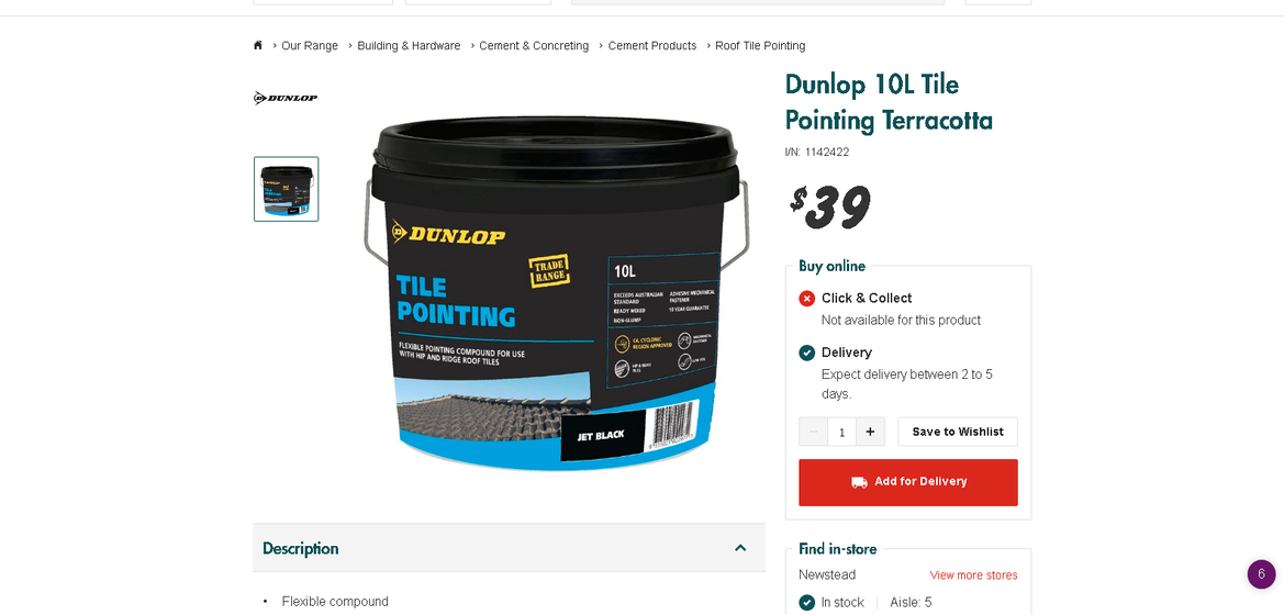

I had a go at repointing some of my roof - just dont rush it and it should look fine. I did mine with a pointing trowel and some dunlop pointing from bunnings which can flex slightly apparently. I just used a flatblade screwdriver to knock old suspect pointing off and used a wire brush to clean first.

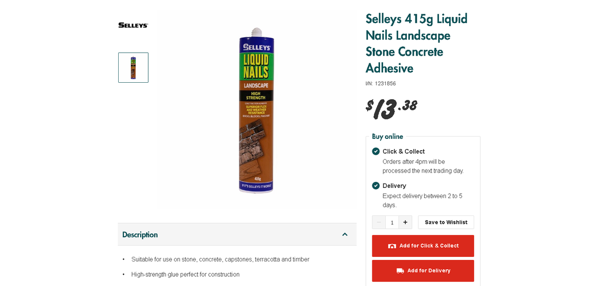

I agree with @Prawns  recommendation. Please make sure that you are safe and that you are accessing your location in a safe manner to avoid accidents. Using a flat head screw driver to dislodge old, cracking and damaged pointing is perfect. I then suggest using a steel brush to remove any loose debris and expose the fresh side of the terracotta tile. If the tile is cracked or needs repair you can either effect a repair while you are up there or replace with a new tile either method will work. I suggest checking the whole roof to maximize your time up there and see if there are any other points that need replacing or repair.
IMPORTANT : Look closely at the way the old pointing is placed in. Notice that there are tiny holes along the pointing. These are known as weep holes and allows the water to drain out as it gathers on the tile. If you do not put weep holes in the proper areas you will do more damage as water will now get trapped under the tile. Observe closely before attempting repair! Look closely where the weep holes are! If you accidentally block one you can still poke the pointing while it is still soft with a thick galv wire or a wire from an old wire clothes hanger. The hole does not need to be very big but it does need to be deep enough to allow water to drain out. Observe closely as you take it apart and place the weep holes in the same area when you put in the fresh pointing. There are dozens of videos mentioning this so please be aware.
Once you've mapped out your repair areas use pointing tool and pointing compound and proceed to repair. There are videos that show how to apply the compound. Best to do it when you know that there will be a few days of sunshine. Make sure to follow the instructions on the back of the can and use PPE as recommended when using this compound. Take care and stay safe.

Screenshot_2021-04-07 Hyde 13mm Tuck Pointing Trowel.pngScreenshot_2021-04-07 Dunlop 10L Tile Pointing Terracotta.pngThis is to repair cracked tiles.This is to repair cracked tiles.
