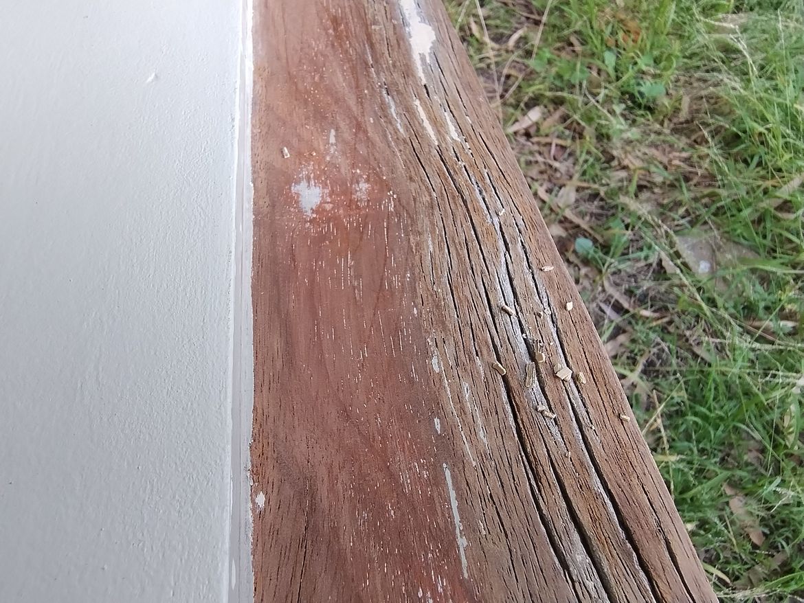

I have an east-facing awning window and its sill needs a good level of attention. My goal is to restore it without having to replace it(full or partial)
Please review the photos.
I have reviewed previous articles in the forum and understand that the general approach is to:
- remove as much rotten wood as possible
- treat the surface with the wood hardener
- fill any void/gap with external-grade wood filler
- prep surface
- undercoat
- top coat with water enamel paint

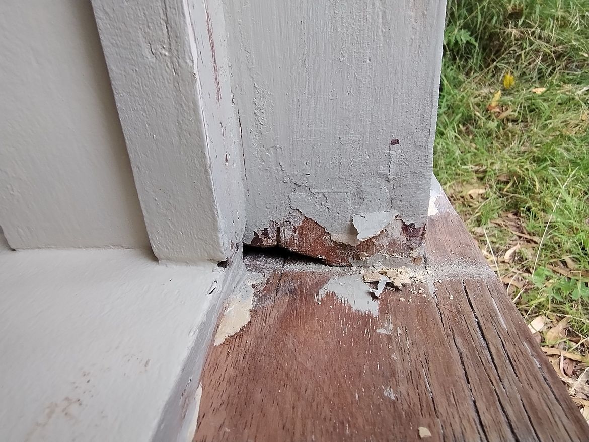

I have previously tried to repair the same section using builders bog & low sheen Weathershield and ended up with paint chipping off (Some of the photos show this)
Do you think this happened because I skipped the process to remove rotten wood & harden its surface?
Secondly, is it still advisable to fill the groove with the bog only after hardening the surface? I think I have already sanded enough.

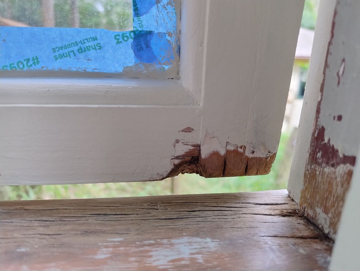

I realise that I may need to trim off the bottom of the jamb/sash using the multi-tool, chisel, etc and refill the space with filler, etc.
