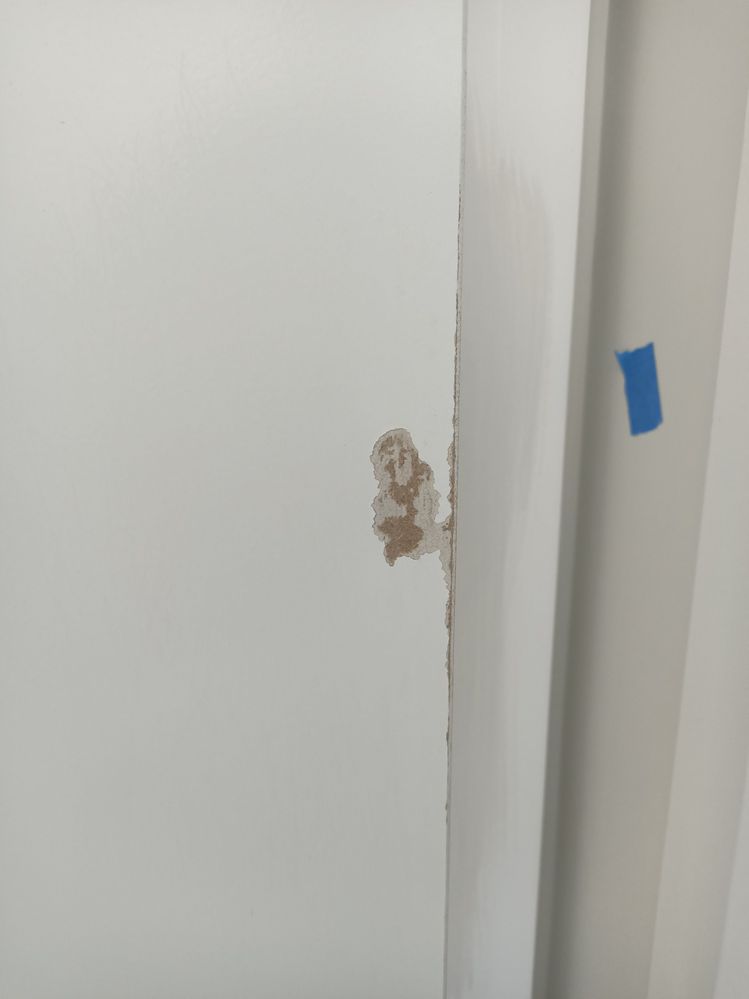

How to repair internal door?
Sustained a little damage on one of our interior doors, How/what should I do to repair?

I suggest using 240grit sandpaper and sanding the edge of the damaged paint area. This is done to remove the raised edge of the paint. I then recommend putting a light coat of UNi-PRO 500g Multi Purpose Interior Filler - 500g. Your goal is to remove the unevenness of the surface.
Once the filler cures, sand the surface one more time and give it a good wipe down before you paint over it. I propose using a sample pot in white to cover the damaged area. Please keep in mind that the repaired area will stand out, but it will eventually blend in as the paint slowly fades and gets dusty.
