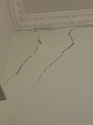

Hi Jacob,
The wall in brick with cement render..
Please see the attached picture…you can see the plaster is loose and I want to glue it back on and then fix the cracks rather than try and replace the whole section which is beyond my skill!
The guy in the video is using building adhesive gorilla glue…but can’t see it in Australia
Hi @ChrisA,
Gorilla Glue is one of our suppliers, and they do have a Construction Adhesive on their Australian website which you can likely order through your local store's Special Orders desk. Unfortunately, I'm unsure if it is exactly the same as the one used in your video.
The method shown in the video does seem like it will work, but it is not exactly a conventional method of repairing something like this. If you'd like to give it a go, it will not cause irreparable damage, but I'm not sure how long it will last.

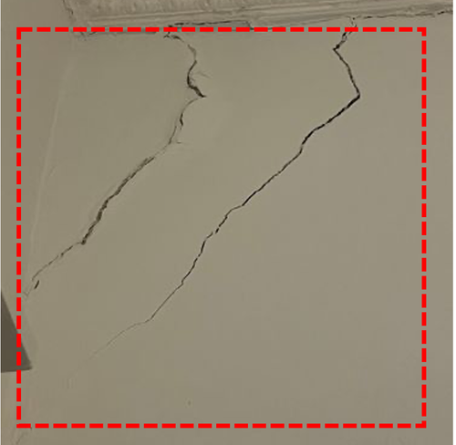

Hi @ChrisA
In your last post you describe your wall is being render over brick, which is not the same as the video, which was plasterboard over brick. If this is correct, I would be recommending that entire section be cut out which you could do then have a professional renderer patch it, which you could then repaint yourself.
The patched render wouldn't be at full depth. There is an underlying issue thats caused these deep cracks most likely within the brickwork. Fixing a blue-board sheet to the newly open section with a flexible adhesive, which the new render would then be applied.
