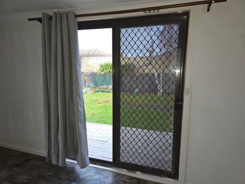

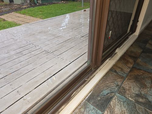

Old sliding doors are difficult to move.
No rollers , just on the track. Is bunning any parts to replace old track of sliding door? How to take out the track?

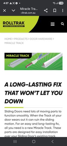

Miracle track cover from bunning is found. Its Rolltrak

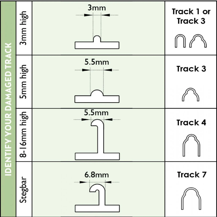

How to buy correct size of track cover from bunning? Please advise
Hi @Honest52,
Apologies, I can't say I was aware of these. They look like a great idea. Thank you for showing them to me.
Looking at the Rolltrak website, this guide will show you what you need to measure and the corresponding track.
Once you have selected the correct track, make sure you give it a good clean to remove any dirt or dust, cut it to length using a hacksaw, then use Metal Bog to fix it on to the old track, following the below guide.

Must admit I did not know of these either. Tho before I go down that path I would be looking a bit more into the base of the sliding door.
If you get someone to give you a hand to lift the sliding door up and outwards, you should be able to pop it off its tracks, then carefully lie it down on the side. You will be able to view the wheels (whats left of them) hopefully. Take one out and head on into Bunnings as they have a range, not an exhaustive range but you could be lucky. If they dont then head into a glaziers place and see if they have some spare. I redid my window rollers this way. The rollers are sad to say usually sitting in a plastic case/piece so they do tend to wear out.
