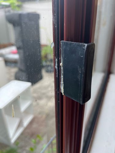

I have snapped the handle off my window and now cannot open the window and it is not obvious how to repair. I’d appreciate any guidance about how to in the first instance open the window and then how to proceed to repair. Thanks!
Re: sliding window cant open after handle snapped
Welcome to the Bunnings Workshop community @Rinnie. It's terrific to have you join us, and many thanks for your question about opening a window.
Is there a brand on the window or handle? There's a good chance that you'll have to order a new handle from the window manufacturer. Regarding opening the window, you might have to remove the remaining section of the handle. To remove the handle, I'd imagine it is slid onto the side channels of the window, which requires the window to be removed. Does the handle freely side up and down the window frame?
A word of caution that the glass can break exceptionally easily. One small tap and it can shatter. I'd recommend wearing full PPE, including safety glasses, a face mask, a long-sleeved shirt and trousers and enclosed footwear.
If you are unable to identify the manufacturer for handle replacement, then you might like to enlist the services of a glassier to remove the handle. Once the handle is removed and the window freely slides, you can install a window lock in its place.

Hi Rinnie,  I think I have the same latch and mine has just broken - no branding on it that I can see though?
did you find a solution for this?
Re: How to repair sliding window with snapped handle?
Hello @bigtony386
Let me tag @Rinnie to make them aware of your query. As a possible alternative, I suggest having a look at the various Window Locks available at the store. They will work with sliding frame sets and those that are in line with the window sills. I suggest visiting your local store and see which one suits your needs.
