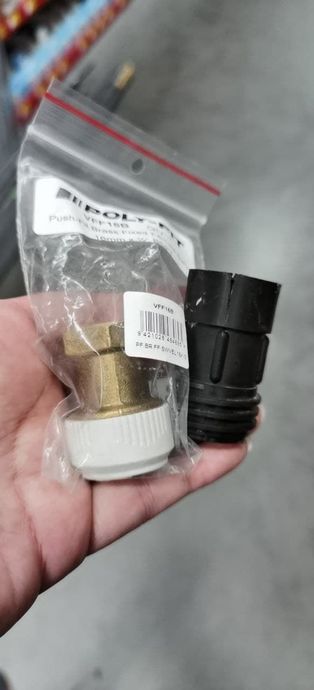

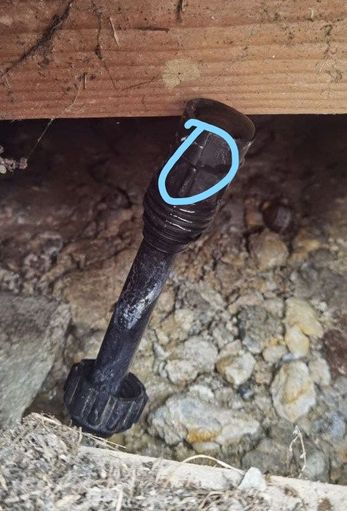

Hi there, I got one water hose connector cracked, the black water hose is approximately 18mm wide and seems to be the main water hose into the house.

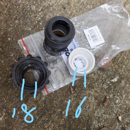

However I can not find one connector in Bunnings that has the size 18mm*1/2", I bought one Poly-Fit 16mm x 1/2" Brass Push Fit Fixed Female Swivel, but the black water hose is very tough and cant fit.

What you have there is more than likely 19mm MDPE pipe (aka Alkathene).
That white/brass fitting looks like an adapter for Hepworth pipe.
You really need the correct MDPE fitting to make this work.

Is your fitting connected directly to the water meter or is it connected to another pipe? I suggest testing the Marley Philmac 20mm x 3⁄4” 3G Metric™ Female Connector or the Marley Philmac 20mm x 1⁄2” 3G Metric™ Female Connector. These compression fittings could possibly work with your pipe. I recommend cutting a small piece of your pipe and test it on the Marley-Philmac Fittings and see which one fits best. Ask your local store's plumbing specialist to help you identify the fitting that will work for you.
However, if none of them fit, I suggest engaging the services of your local plumber to help you identify the fitting that will work for your pipe. Due to to the age of the pipe the fitting might have to be specially ordered at the store's special orders desk.
