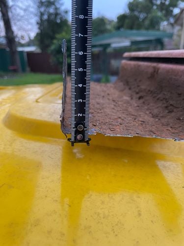

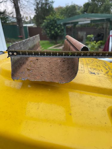

Hi, I need to replace some of my guttering (I think it’s aluminium)
but I’m not sure exactly what I need as I don’t quite understand the sizes online. Measurements of my gutter are 6.5cm in height, 13cm in diameter (including lip). Any help/recommendations would be great - thank you.
Hello @Will01
Thanks for sharing your question about your gutter. The gutter you currently have is galvanised and is commonly called a quad gutter. I propose bringing your old gutter to the store and comparing it to the ones available on the shelf.
Generally, there are two to three gutters on show, but it all depends on their availability. The sizes you've show are very close to the quad sets available, technically 62mm for the back, 115 for the bottom and about 80 to 90mm at the front. Looking at the photo you posted yours looks very similar to the low front model.
Here is a link to the Fielders Gutter products: Fielders Brochure (yours would be on page 4 bottom of the page)
If you are having difficulty in matching the gutter, I suggest speaking to the special orders team at the store and they will try to match the gutter for you.
