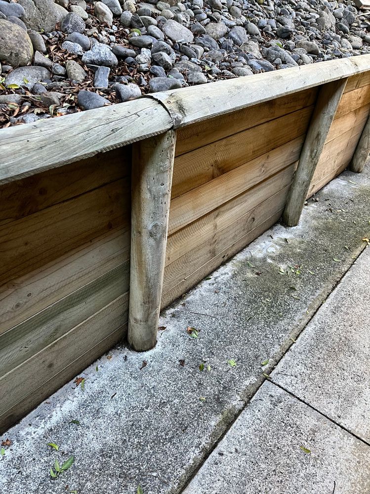

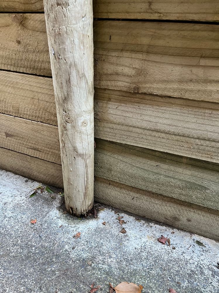

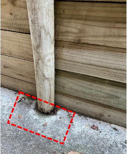

Some posts are showing clear signs of rotting, with material loss at the ground level, which I think require replacement. What is the right way of doing this? Thank you.These appear ok?These appear ok?This one requires urgent action.This one requires urgent action.

Generally speaking, support timber pieces will need to be attached to that section of the wall to prevent it from moving further while you repair the post. The concrete base will need to be broken in order to remove the old post footing. Once that piece has been removed you can then replace the entire post with a new one. Make sure to double check the size before purchasing the new timber post. My best advice is to paint the new footing with Gripset Betta 1L Waterproofing Membrane Bitumen Rubber to extend its service life.
However, if you feel that this is too involved, I recommend engaging the services of a builder to fix your retaining wall post.
Let me call on our experienced members @Dave-1, @Nailbag and @Noyade for their recommendations.

There is a lot of weight behind that wall. So, before removing a rotting post, each sleeper level either side of the post to be replaced will need to be supported diagonally down and connected to the concrete ground. Then the concrete around the post needs to be cut large enough to support larger galvanised steel posts that are then concreted in to place.
I'm not sure I would risk doing this myself due to the supporting weight. Should the supports give way during the replacement, it could prove to be quite serious, not to mention dangerous.
I would recommend searching for a company that specialise in engineered retaining walls as a starting point.

Nice tidy and straight retaining wall :0 Shame about thye posts rotting out 😕  And the answer I would be thinking of removing the rocky soil from behond and then redoing the posts, waterproofing them as @EricL has suggested. Trying to remove posts that have been concreted around and also look like they have been put in place properly would be hard to do individually let alone if they had nothing around them.
I would be thinking of a replacemenmt of the wall depending on how many posts are rotted. If the wall has 5 posts and two are rotting then Id be factoring in replacement efforts, 1 post, Id still remove the fill  to get rid of weight issues while working and remove that post. 7 posts and 2 are rotted... maybe try one post first and see, my concern is the amount of fill the wall is holding back so any weaking while removing will make the wall want to move.
How many posts out of how many pasts need replacing and are they next to each other in the run up the retaining wall?

I agree with @Nailbag that this is a job for professionals. The wall appears to be leaning slightly, which is an indication that the weight it's bearing is significant. The current posts can not be removed until the wall is properly braced in place and this isn't a DIY job.
I'd suggest reaching out to a professional, as your safety is the number one priority.

4 A - I would think not, you will need to cut/break up the concrete around the posts in question before even attempting to dig new holes, possibly finding out more of the post is rotted then you expect. The lateral force of the soil behind the wall I would not think of a steel post being added to it would solve the issue. (not knowing how thick and the makeup of your concrete slab as well) Thats a LOT of force being pushed against the wall and a post bolted, well it would be like holding back the Titanic i would suspect :smile:

It's great that you've received excellent answers from @Dave-1. Just keep in mind that it's very likely that the posts were also concreted in aside from the slab that's holding it in place. Starting from the shorter end of your retaining wall sounds like a good idea. Plus, it will give you a general idea of how much concrete you'll need to break apart.
