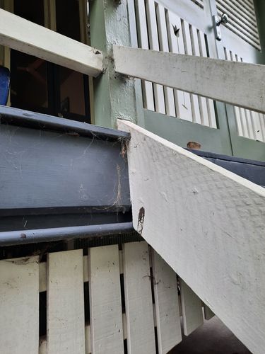

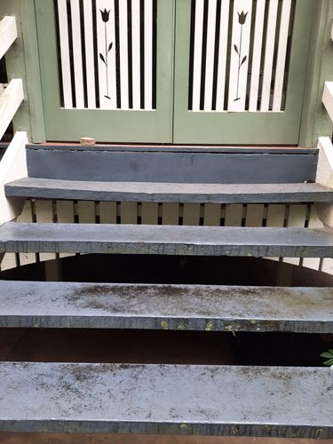

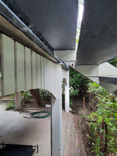

I need to replace the top wooden stair tread on a highset old Queenslander with traditioal wooden stairs. The top tread is worn from extended use and is visibly bowing when trodden on.
Any of the other treads would be easy to replace from the back of the stairs, but I can't see a way to slide a new tread into the grooves cut into the wooden side supports without lifting the whole staircase away from the front of the verandah, or undoing the bolts on the threaded rods that hold the sides together, and risking having the other 11 treads dropping out. Any advice on how to solve this would be greatly appreciated.

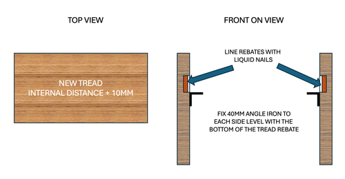

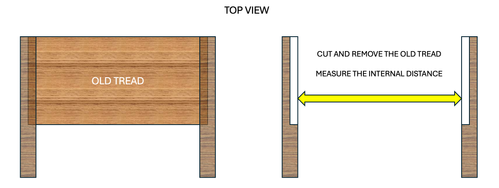

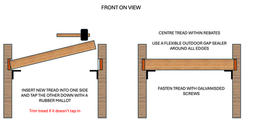

Hi @ObiSteve_-7 this is a difficult project that both @EricL and @Dave-1 have provided a few good suggestions to consider. A few years back I had a similar issue when preparing my parents old place for sale, except I had multiple treads to replace including the top one which backed on to a brick wall. As another possible solution which is relatively an easy one, but very structurally sound. I have stepped out in the images below how I did it using these products:

Thank you for your suggestions fellas, all greatly appreciated. Unfortunately Eric's suggestion isn't suitable, the fascia Is nailed directly to a 22 foot length of hardwood 7"x4" bearer cut in 1903 from local timber, cutting the facia out still doesn't give me sufficient room.
Cutting the current step out and replacing it with a slightly shorter one supported by gal. angle iron, with appropriate gap filling and painting would be a perfectly sufficient repair but I don't think I'll use it, it would be obvious on close inspection that it was a modern tech repair on an old building, and the front stairs directly face the street.
The extra 2 stair rods supporting the existing top stair tread is one that I hadn't thought of, and do like a lot. The building was a school classroom for 100 years, and while the current stairs aren't the originals, it does take a lot of kids foot traffic to wear old hardwood stair treads. The stairs already have 2 half inch (12.7mm) threaded rods at 1/3 and 2/3 up them so it will look like it could have been an old education dept. repair before they sold the site in 2007.

Hi @ObiSteve_-7 Understanding your concerns for any visual sign of repair, your could make a shallow rebate at each end of the new tread with a simple hammer and chisel the width and depth of the top of the angle iron and then painted the same colour as the tread. This would do probably the best job of concealing the repair. Remember any single tread replacement is going to look different in some respects to the others, until its had some aging.
Failing this your only other option is to pull the stair case off, and then you might as well look at the condition of all the treads.

And if I later decide to do a complete repair, I will probably cut the existing tread out, extend the existing rebates for the tread though to the front of the side rails, get a new tread cut to the imperial dimensions of the others, slide it in from the front, cut a couple of wooden filler pieces and slide them into the extended rebates and complete with modern glues and gap fillers.
