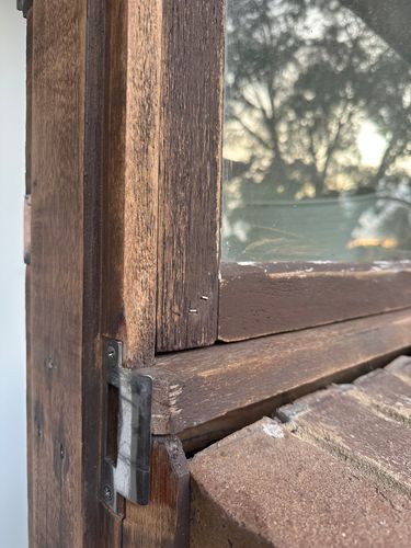

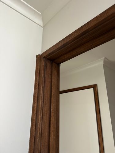

At this stage, we are sanding them. It seems like they were stained/varnished before (please correct me if I am wrong, I am just a beginner :unhappy: ). I have a few questions:
1. Do I need to sand more or is it all right?

2. I dont know what kind of stain they used before (oil-based one or water-based one, my house was built in 70s). What kind of primer/undercoat should I use?

Your sanding effort looks great, I propose using Zinsser 1L White Bulls Eye Primer Undercoat Sealer And Stain Blocker. It is a water-based primer and will prevent tannin bleed through. My best advice is to use masking tape to cover the floor and wall areas you don't want overpainted.

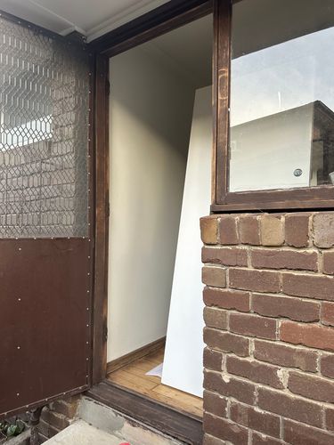

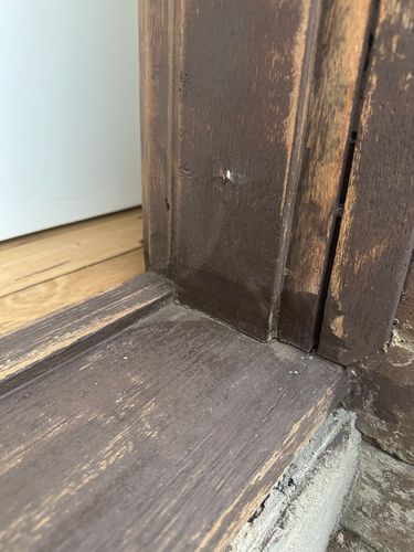

Hi Eric,

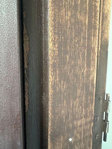

There is a door frame to outdoor that is harder to sand. I don't know what kind of material it is and how did they do it, but I cannot sand it back to timber. As you can see there are a lot of areas that are not back to timber. Do you have any suggestion? Ideally I want to use the same primer/top coat with the skirting board, but I am open to all suggestions.
Thanks
Re: Revive door/window timber frame
Hello @tonytr
I propose using a 40grit sandpaper on this section if it appears to be very hard. I also suggest using a detail sander to assist with the sanding. Please keep in mind that the lower the number of the sanding pad the rougher it will be. Make sure to finish the surface with a 240grit to get a relatively smooth surface.
The only other thing that comes to mind is to use Poly 1L Polystrippa Paint Stripper in combination with a Craftright 5-in-1 Scraper. Please remember to use personal protection such as gloves, goggles and a mask when using the paint stripper. Please make sure to follow all the safety guidelines printed at the back of the can.
