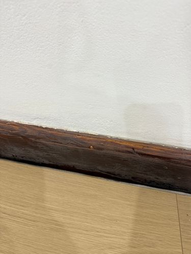

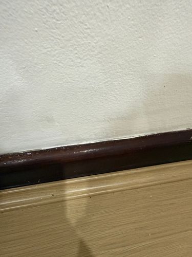

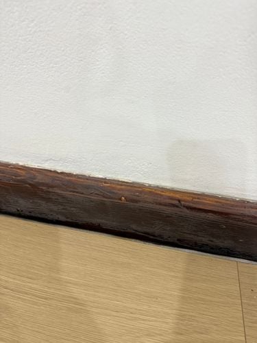

Hi everyone, I’m planning to paint over all skirting board to white color. Just want to know if I really have to sand all skirting board. I have tried sanding some skirting. After cleaning, as you can see the photo, it seems like the sanding is very superficial. Do I have to sand deeper?

If you can identify the type of paint, oil or water-based, following Eric's advice, then there would be no need to sand it all off. A light preparatory sanding, such as that you've already done, would suffice.
You would then just need to use the correct type of primer, followed by the correct type of paint.
If it is oil-based, use Dulux 1Step Oil Based Primer Sealer And Undercoat and Dulux Super Enamel in a gloss and colour of your choosing. If it is water-based, use Dulux 1Step Prep Primer, Sealer & Undercoat and Dulux Aquanamel in a colour and gloss of your choice.
