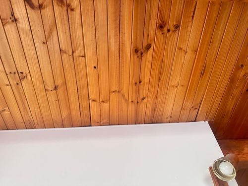

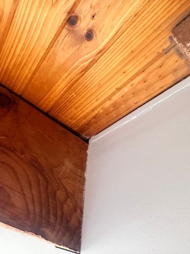

In need of some advice. We have just moved into a new home and we often are finding the smell of smoke in our house as it is not sealed off. We live on farm land so constantly burning going on and it fills the house. We are wanting to try seal the house to keep out the smoke. We have a large living kitchen area that is wooden and is full of gaps. Not sure where to start to fill it up? Any advice would be handy. See pictures for the layout and the gaps.

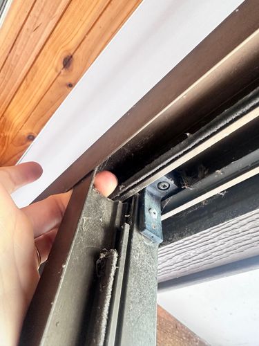

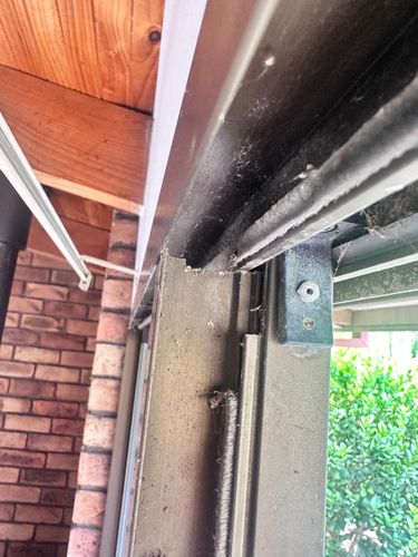

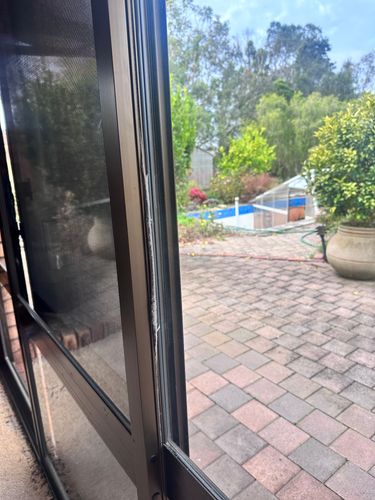

Another place we think air is leaking in and out is the sliding doors, the house was build in the 80/90s so the seals aren’t too flash anymore. I have attached images of the frames and would love to know how to reseal these again. All help is appreciated so much as I’ve truly got no idea and really want to wake up in a smoke free house. Thank you!!

The timber gaps you have shown can be sealed using a timber-coloured gap filler such as Selleys No More Gaps Timber Gap Filler. You might like to check out How To Silicone a Gap for some guidance on how this can be done.
With the windows, the seals are often proprietary to the specific window unit, but you might find some success using a general weather seal such as this Syneco 6 x 9mm x 5m Black Self-Adhesive Door Window Weather Seal.

We have just recently replaced the runner (support) rail on our back aluminium sliding back door (circa around 1980s) and had similar issues sourcing replacement parts, Bunnings supply an alternative adhesive foam seal that proved exceptionally well suited to use as a weather strip (also to keep unwanted insects out on a screen door/frame making surface) 😉
https://www.bunnings.com.au/moroday-grey-econo-self-adhesive-weather-seal_p4061873

I was thinking timber trim around the top edges you have shown to fill that gap. I do like @JacobZ 's suggestions, maybe a mixture of both? The sliding door is a little harder to seal, especailly an older door. I have the same issue with mine. My solution to stop draughs (smoke) enetering so easiyl was a heavvy rubber backed curtain. This really seems to work for my draughs. I considered replacing my door... considered is the word, no $$$ was the answer ![]()
