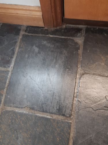

When I seal slate with gloss sealer and a brush I leave brushmarks.  What is the best way to apply gloss sealer to eliminate brush marks.

Could we start with what product you are using and whether you are using a synthetic or natural brush? How wide is the brush? If you are not getting a satisfactory result, it would be best to look towards the application instructions to see if an alternate method is advised. Perhaps they might suggest a roller or application pad.
What sort of preparation was done on the tiles before application? Many slate sealers require removing the previous coating entirely with a sealer remover as it can lead to a streaky or mottled finish if they are not.

Thank you for your reply.  It is Tasman chemicals .  I havd tried roller and lambswool but it sticks to them.   I have stripped some same result.  I use a cheaper brush and dispose of it. The product is solvent based. I am at my wits end , hope you can help.   Many thanks Shirley

Can you show us what type of brush you were using @shirley1231? If the bristles were a bit stiff, it could be causing drag marks. If it were a budget-friendly option, perhaps try something of a higher quality like the Monarch 63mm Woodcare Paint Brush. Also, ensure you hold the brush at a shallow angle to the surface and not perpendicular.

Thank you I did use  budget friendly  paint brushes because I discarded them. How shallow an angle?. How do I keep brushes soft as I paint? Would a solvent based gloss from Bunnings paint over Tasmans solvent gloss.  For future reference.   Many thanks  Mitchell.

I suggest starting at a 45-degree angle and then start going lower so that you have full brush contact with the floor.
At the back of the sealers container there should be instructions on how to clean the brushes after use. In order to keep your brushes softness, it must be cleaned properly after you've finished painting. If sealer dries on the bristles of the paint brush it can no longer cleaned off.
