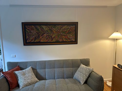

Re: Gallery/art hanging system questions
image.jpgTrack now 2.8m joined with joiner piece in kit. I wanted it centred on the wall despite the couch being off centre.  If I move the lounge along the painting can slide along to remain centred to couch. I will possibly
hang something small at the lamp end as well..
