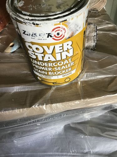

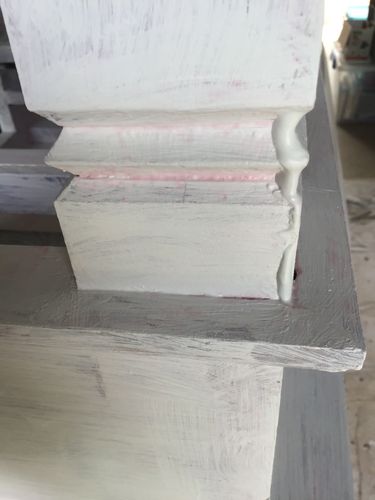

I have used 2 coats of Zinster cover stain blocker on an old table I used a paint stripper and have sanded the wood back. After 2 coats of the stain blocker I can still see some stain coming through. Will the stain disappear once I have applied my 1 top coat of paint or do I need to do something else that

It appears that the stain is very strong and is bleeding right through the primer. I suggest applying another coat to stop the old paint or stain from bleeding through. This sometimes happens when you have a very strong stain painted over your timber surface. A third coat might be necessary to seal it properly.

Hi Eric I took your advice and have painted another coat of primer on my table. This does not seem to have made much difference as the red stain is still showing through
i spoke to a lady who rejuvenates furniture for a living . It’s worth noting the since my table was made in Asia somewhere they tend to use kerosene to thin their paint and she has suggested that is why the stain keeps re appearing .I was going to paint the table white but she suggested that even if the stain disappeared after painting it could reappear several months down the track and ruin my project. I have therefore gone with a black paint for the main part and intend to do the top a lighter brown or maybe just wax it
The person I spoke to suggested I would have been better not to strip and sand but to just use primer over the original stain as the timber has already been sealed by using a varnish or some sort of shiny finish.

I'm sorry to hear that the stain still passed through the primer sealer. It's highly probable that there is a strong chemical such as kerosene that is bleeding through the primer. Your choice of using a black paint is a good idea as it will hide any stains that might come through. In regards to sanding, I suggest using 240grit and just lightly sanding the surface to remove its shine. Clean it off before you apply the next coat.
