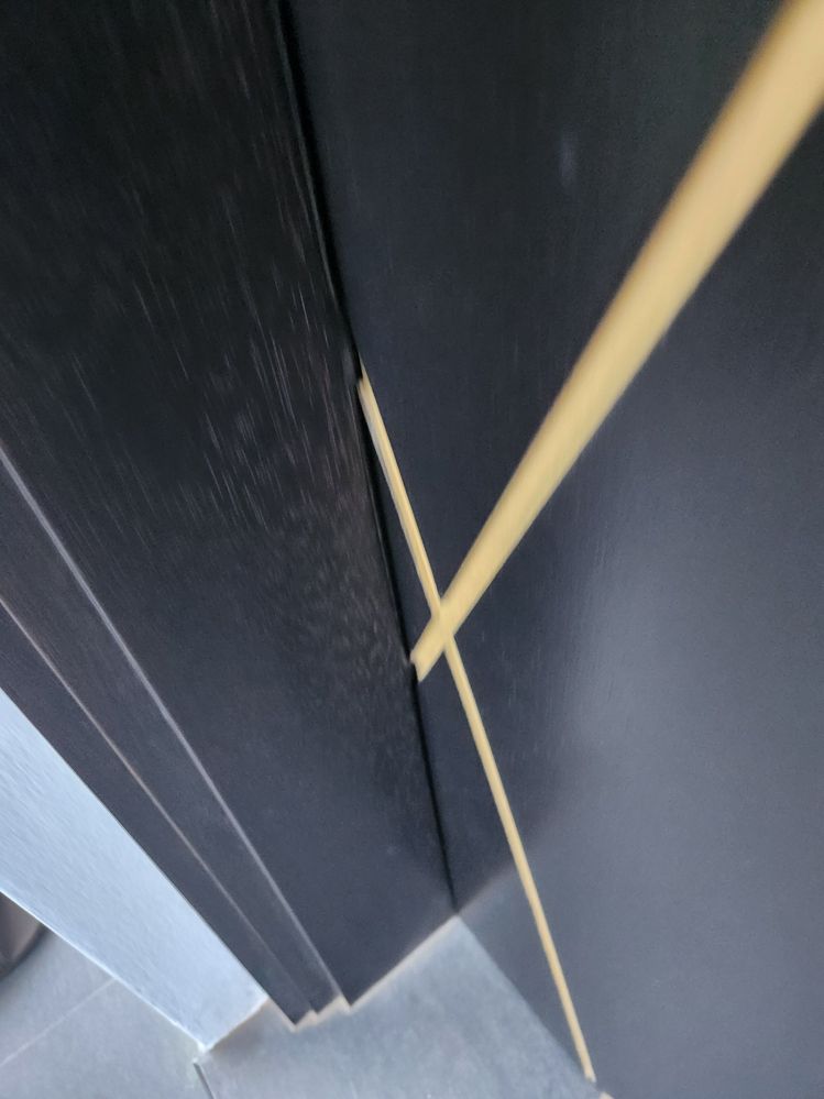

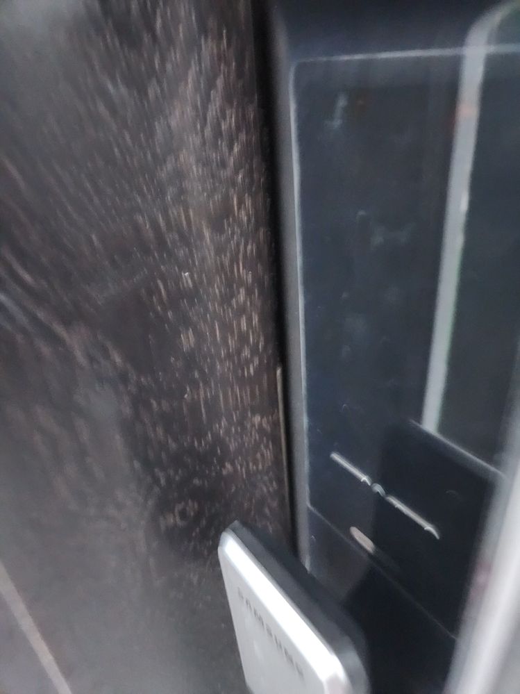

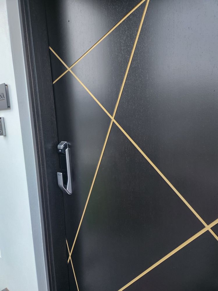

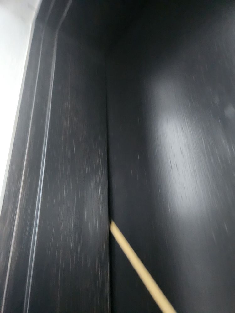

Hi Eric,

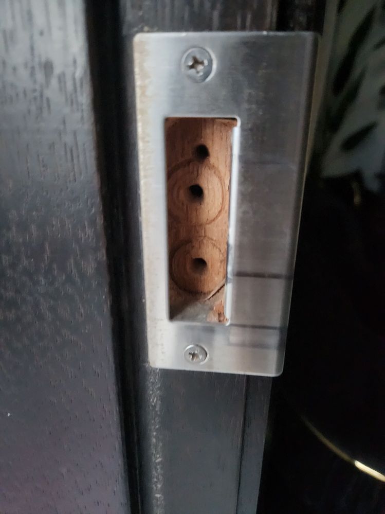

Please see the photos attached. The door is out a little not too much but can't close it properly. The latch on thr side has already been moved once see the photo and can't be moved more.

Thank you for posting a picture of your door, it appears that the bend on your door is not so bad. I see two possible ways to repair this, first, I propose using a planner on the upper left-hand corner of your door to reduce its thickness. This will allow the door to come closer to the edge of the door frame and its original position letting the doors lock engage properly. Once the door is in the correct position you can then paint the planned surface
The other option is to remove the striker plate and filling in the screw holes with liquid nails and timber dowels. This will then allow you to move the striker plate to a better position to receive the lock.

If you dont want to go down the path with the carpenter and yeah I get that as well. Id go with option B of @EricL's and move the striker plate via filling the old area in and recutting it.
Frames do move with changes in weather and weather seals can mask the "look" of it being bent so the striker plate move would be the most eye appealing fix.
