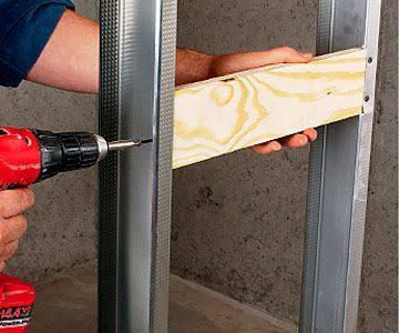

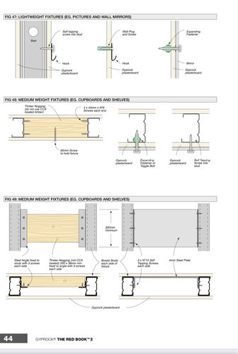

Obviously I'm going to have to get in the wall by cutting out bits of the plasterboard. What would be the most effective change? Was thinking wood inside the metal studs that can be used for better screws, and some form of insulation to dampen vibrations. Any other suggestions other than completely rebuild the wall?
