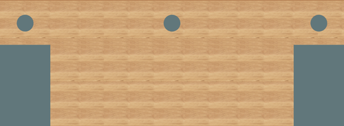

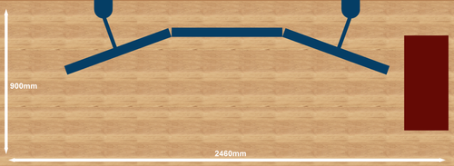

I'm looking to get a particle board/laminate benchtop that is 2460mm(W) x 900mm(D) x 38mm(H) and weighs 51kg.
It will support 3x monitors (~5kg each), 2x monitor arms (~5kg each), 2x Speakers (~2.5kg each) all at the back of the desk and centered to the width of the desk.
I will also want to place my computer on top of the desk with dimensions of 240mm(W) x 515mm(D) and weighing ~20kg to the right of my monitors.
I've messed around with a couple considerations (2nd pic), including some desk drawers underneath each side at the front, with 3x desk legs situated at the back but unsure if this would provide the required support.
Hoping to get some advice on what type of supports/legs to use, best placement for them and anything that can help to prevent any type of sag through the middle of the desk top. If there is a solution that doesn't involve a desk leg situated in the exact centre of the desk, that would also be much appreciated.

Hello, I made a corner desk once with similar considerations. Instead of legs, if you make squares/rectangles out of things like this https://www.bunnings.com.au/70-x-35mm-2-4m-short-pine-kd_p0165357 with this sort of join
Then you end up with pretty sturdy structures. Then, you place these probably two units along the back, two on the sides, two across the front and if you want it really strong, two underneath, e.g. like in the below.
You can bolt them into posts for easy joining. Then, securing the top can be as simple as using a whole bunch of these little brackets https://www.bunnings.com.au/zenith-20mm-zinc-plated-angle-bracket-16-pack_p0044061
It means you are distributing the load across more surface area of the stronger timbers which then transfers that through the lap joins into the vertical members. I was able to stand on my (admittedly not as wide) desk. Also, instead of attaching your monitor arms to the desk surface, you can secure them to the more robust supporting timbers underneath. If you wanted it prettier (and stronger), you also have the option of attaching plywood panels to the outside of each square unit.
Also, if you assemble all this with screws and bolts, it is straightforward (if tedious) to disassemble it for moving, which is something I did with my desk many times. It's a bit unconventional and needs a bit more work to make pretty but it sure was practical and easy to do.

Hi @JWDESIGN,
It's fantastic to see @SensibleHill has already jumped in with some great advice.
At 38mm thick, your desktop is already going to be pretty solid, but additional reinforcing will likely be worthwhile. I think using 4 legs at the back with your 2 drawer units at the front would be good. Something like these Taskmaster 700 x 50mm Black Steel Table Legs mounted to the underside of the tabletop would be a good option.
I would install the legs and the drawers, then assess how the desk feels. You can always add some bracing to the underside of the desk after testing if you feel that it is needed. The bracing could be made from timber or steel, depending on what you prefer. 70x35 pine or some Australian Handyman Supplies 50 x 25 x 2.0mm x 2.0m Painted Rectangle Hollow Section Steel would work.
As the main area that needs support is between the drawers, something as simple as this should be enough.
Being 38mm, you would have plenty of room for screws to go up into the underside of the desktop.
Let me know what you think. I am happy to help out further if you have more questions.
