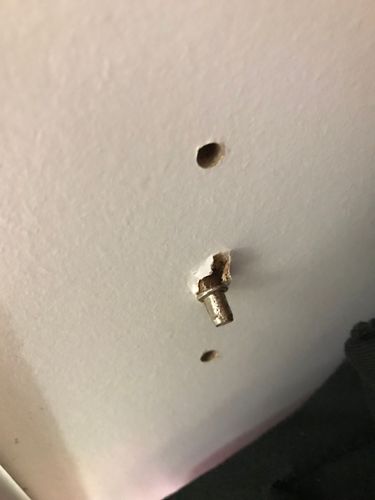

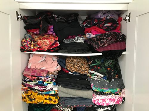

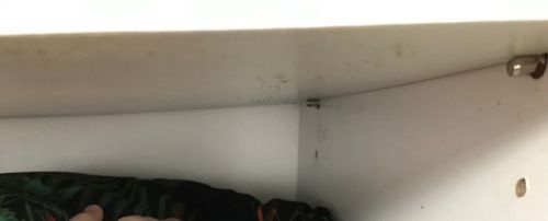

I’ve added some photos to show what is happening; & how one pin was torn from the cupboard wall when the shelf collapsed
