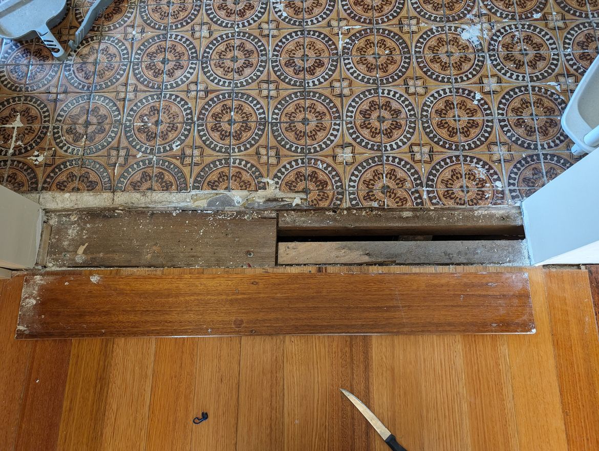

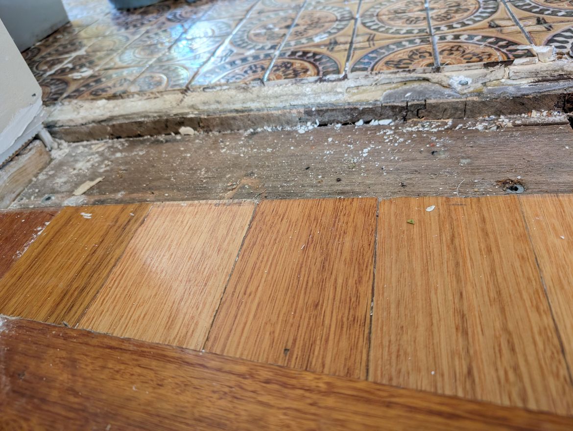

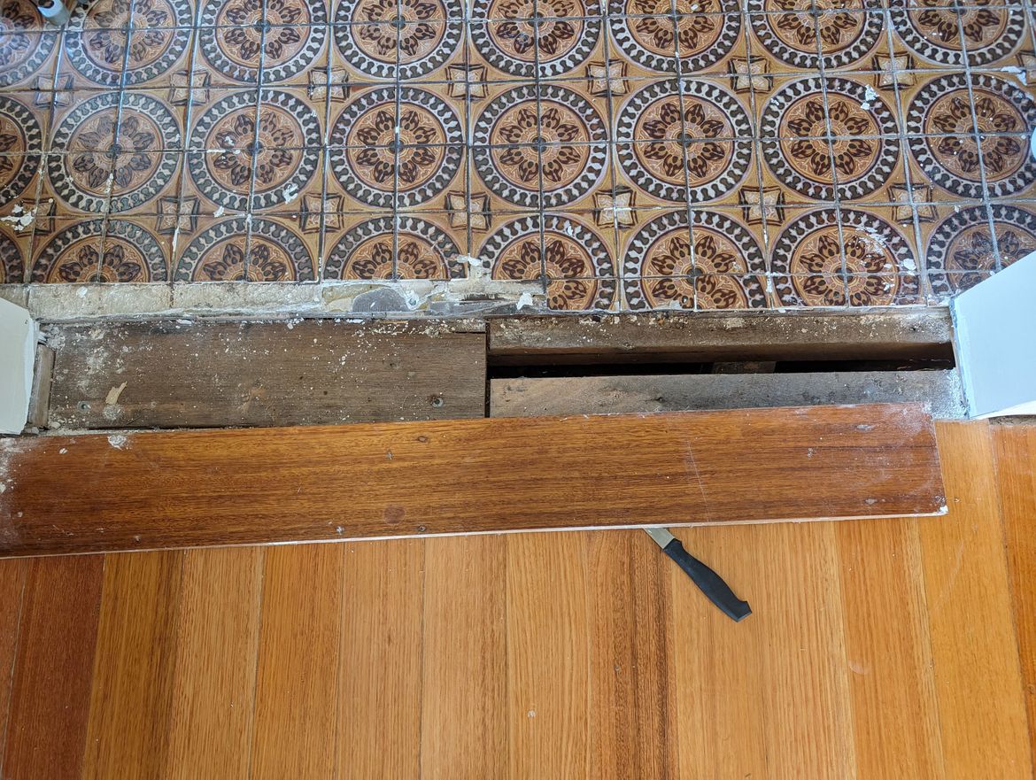

I have a transition - for lack of a better word that i need to resolve. I am not sure what to make of this but we will start from where we are.
The 2 floors are approx. 20mm difference in height - The tiled side higher. The width of the transition is approx. 140mm wide.
My thoughts was to put in a piece of yellow tongue to bring the height of the transition to the same height as the wooden floor side, then some form of timber, say as pine skirting with a sloping (from one of the bunnings workshop hacks).
Keen to hear from the wealth of knowledge in this community on how to achieve both aesthetics and functionality.
Thank you in advance.

It always amazes me whats under a piece of flooring
You actually have les sof a transition then I do at home
Two ways that come to mind straight up
Way One
-Place that piece back and then use something along the lines of QEP 3.3m Silver Cove Plank Trim or Roberts 3.3m Plank Cove Trim - Light Bronze to cover the rough tiles and the step up.
Way two
- Harder to do unless you have a bench saw. You could replace that piece that you have removed with a new piece that has been cut at an angle to give you that 200mm height. You will still need a trim bit to cover from the edge of the timber to the edge of the broken tiles tho.
Do you want a ramp or ned one or is a "step" ok?
If the step is ok then
Way Three
- Use this Hanwood 2.4m Blackbutt Vinwrap Floating Floor Quad Trim and if you are lucky enough to have some of those spare tiles you could replace the missings ones? If not then Id be looking at an edge that covers that distance into the step. Hanwood 2.4m Brown Junior End Timbertone Flooring Trim and cutting off the short side so you can butt it up against the tiles and cover the broken ones.
Thank you @Dave-1 for taking the time to provide me with the different options. I will probably go with the step as it may be simpler and cleaner to execute rather than a ramp of 140mm.
Thanks
