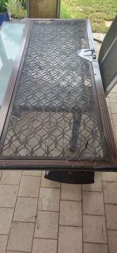

Hi I am wanting to turn two old security doors into window screens.  Any one have any previous experience with this or any tips tricks or ideas. Thanks

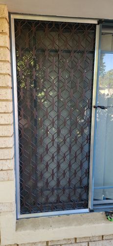

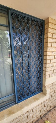

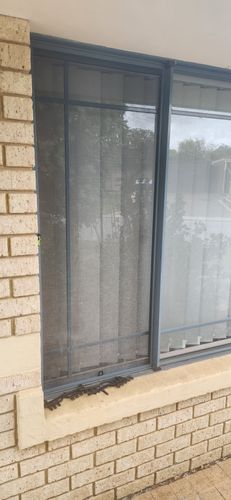

Ended up just cutting to size and riveting some angle in front to hold it in... needs another coat on the angle still but I'm pretty happy with it.  Just got the other window to do now

They look great right now, but with a fresh coat of paint, they'll look fantastic.
Nice work and thank you for the update.

They look pretty nice :smile: The paint on my redone screen door has flaked a little in the year or so sonce ove done it. When you go to paint the screens it might be an idea to prep it more so then I did with mine (I wire brushed all the flaky stuff and then spray painted with white and black)
The other thing is if you are goingto go for two toned colouring (white and black) then get the order right :smile: It was a pain when I did it.
