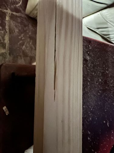

Hi, I am trying to use an 18v Ryobi circular saw to cut pine, but every time I try it, my saw just stops. can someone please help me TAT, I'm new to using power tools. Thank you.

Congratulations on your first foray into the power tool territory. It appears that you are cutting the timber along its length. This type of cut is called a rip cut, it's important to mark the timber with a pencil guide so that you can keep the saw straight and prevent the blade from wandering. If possible, I also suggest using the "T" guide that came with your saw. It's great way to guide your saw and keep your cut straight.
When doing a rip cut the cut timber behaves like a clamp and presses on to the saw blade as it travels into the timber. I suggest putting a wedge at the beginning of the cut so that it separates the cut pieces. The farther you go into the cut the larger the gap must be. This will stop the timber from pinching the blade and stopping your saw.
It's also critical that the timber piece be on a flat surface or supported by a minimum of two sawhorses and securely clamped to the work surface. This will prevent the timber from moving and ruining your cut.
My best advice is to allow your tool to cut the timber, don't force it into the timber, this tends to overheat the blade and motor.
Please make sure to wear personal protection such as gloves, goggles, and a mask when working on your project.
Also of importance is the amount of teeth on the saw blade.
Its tempting to go more teeth to give a nicer cut but this means having to go slower.
I think from memory most saws come with a general purpose blade which has around 28 teeth. That should be okay for the thickness of the board but as @EricL says, let the saw do the work.
Another tip that I would suggest it to lay a couple of boards the same size beside the one you’re cutting to make a flatter surface. It would stop the saw rocking which could also be contributing to your saw jamming.
The other guys have given some great tips. All I can add is maybe rub some wax on the blade to reduce friction and lessen the chance of stalling the saw.(Make sure you drop the battery out before you mess around with the blade)
Slow and steady wins the race.
