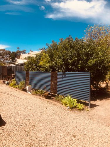

Welcome to the Bunnings Workshop community @jkhandywoman and thanks for jumping in with this great project.
Can you please share a bit more information about how you constructed this fence/privacy screen? Either the materials you used or the installation process?

Hi
I purchased 4 bags quick set concrete
Corrugated colour bond left over from recent shed build
6 of 50ml x180 steel posts
2 panels from Stratco reduced
Measured length needed..
Add string line and dug holes x 6 divided into sections.
Constructed the first frame and attached the iron and panel..
stood up into the holes
Used spirit level and propped up level put concrete powder in holes and watered
Repeat for other end and then cut sheets for centre ..
