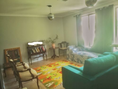

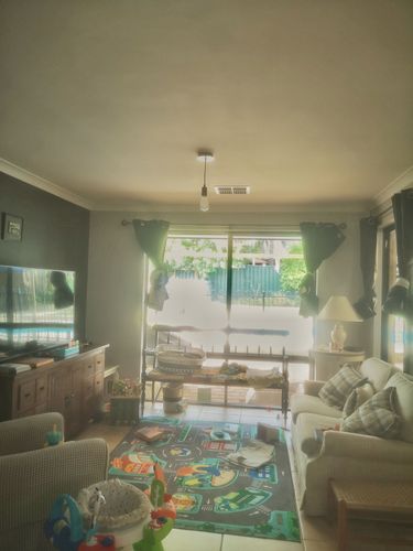

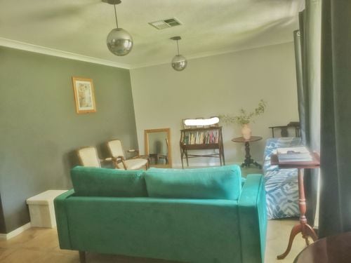

(Apologies for the mess) Our ceilings are a standard 2.4m high. Want this formal seating to be modern English country while the rest of the house will be more of country cottage.

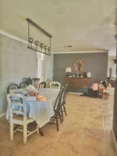

Dinning room doesn't get much of the daylight so thinking of wall colours to make it look brighter.

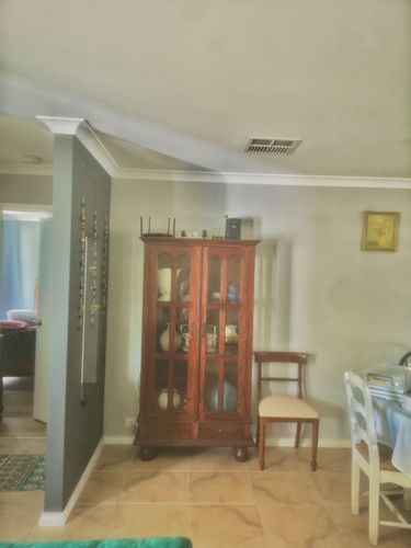

Not sure what to do with this separation wall here. Should I paint it a neutral colour or wallpaper it to make it look more bearable?
These are some ideas I'm thinking for that separation wall.

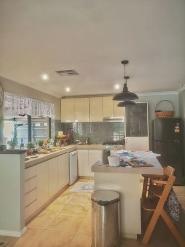

Want to the have shaker cabinets raised all the way to the ceiling and shift the stove/oven to the center. Also upgrade the bench top to a natural material.

Lighter colours typically make a space look brighter and larger. The separation wall could be a good opportunity to add wallpaper and make a feature out of it. That's likely something to decide on later down the track once you've achieved your other projects. There is no point creating a feature now if it overwhelms the space.

I'm thinking of starting with the formal seating area and want to paint the walls including the ceiling a dark moody green to give it depth - preferably Dulux's Amphitrite (while keeping rest of the spaces a lighter shade of the same family)
but since it's an open plan, I can't figure out how I should paint the ceiling of the living room without making it look awkward for rest of the spaces. Should I build an archway in the top half to section it out?

That's an option @MikaRJ. Even adding a strip of something like Porta 30 x 8mm 2.4m Rounded Edging Bead Clear Pine across the ceiling would provide a visual reference to the painted area's division and border instead of abruptly stopping. Could even fancy it up with a profiled beading.
