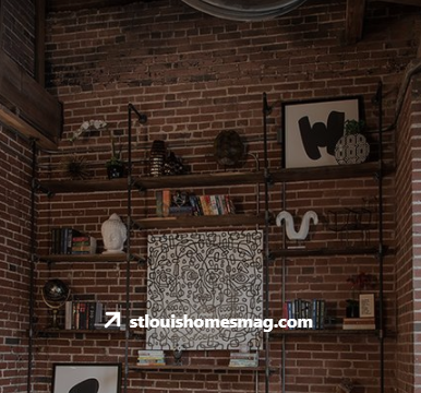

Hi I'm looking at creating an accent wall in the dining area - to look like red rustic brick. I don't want the wallpaper and I am on a budget. Is there a cladding / wall lining that will give this look?
