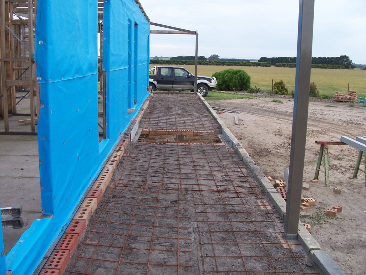

Whilst building our new home, hubby and I spent an obscene amount of time trying to make sure mice or rats couldn't get into either our walls or roof space but so many older homes had no such thing and in fact I know of no builders that incooporate rodent mesh.
As we laid the sub floor or green tongue, we cut a piece of mesh about 20cm wide and as long as we could handle off the roll. Part of the mesh was secured under the bottom plate and then the remaining mesh extended over the air gap and was held down by our brickwork. This then prevents access into the wall space as once mice get in there, they are then in your roof!!
Our electrician in fact laughed at us when we said we were confident that we won't get rodents into our walls or roof because we have sealed off every possible entry point, including around the top of the brickwork where the eaves finish and all holes in brickwork where either electrical or plumbing fixtures come in or go out.
We are even very particular now never to leave doors open as we come and go even though the home is still some time from complete but we don't want to inadvertantly let a mouse in that way after all our other efforts to keep them out.
I know when my son and I refurbished my mothers roof, we disposed of RUBBISH bags full of rats and their nests, absolutely horrendous but we looked for and found all the entry points and sealed them off.
I've enclosed an image of our veranda 's being prepared and to the left of the picture, you can see the rodent mesh just showing under the blue paper and sitting on the foundation bricks that are eventually covered with brickwork.
