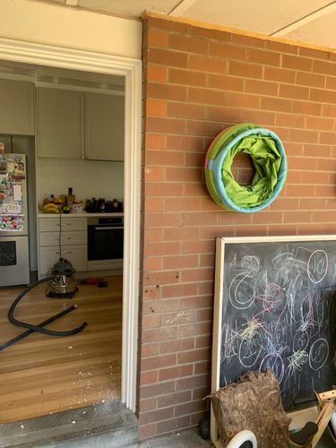

We are putting in timber patio doors here. My carpenter said that because this area is undercover that no flashing is required. I just wanted to check whether this is true or not?
we also want to put the door in level with the floor as at some point we might install decking so can go straight out onto it. Does this seem feasible?
