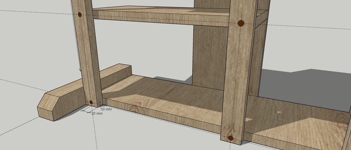

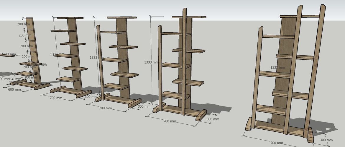

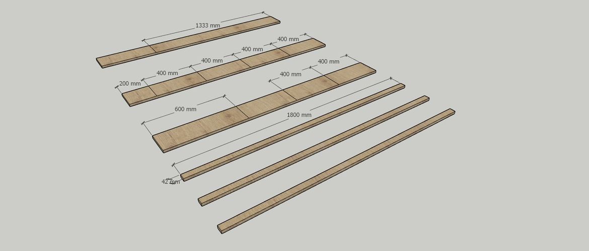

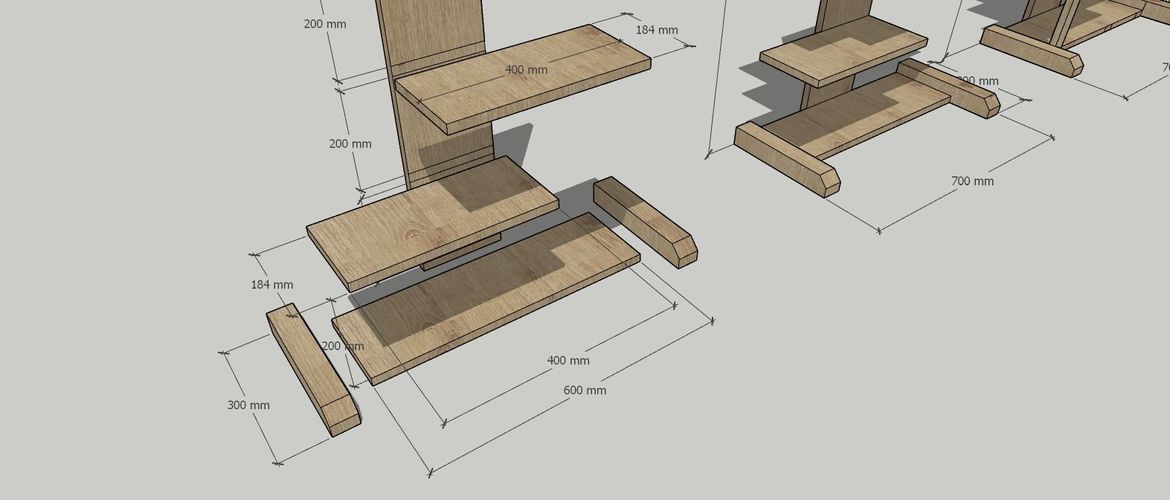

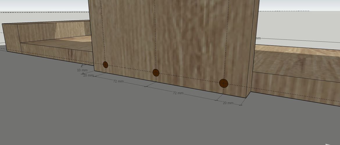

Hello @sydneysider
Below is a cat tower I've drawn up for you. I am aware that you wanted a ceiling mounted post type tower but I would ask that you have look and consider if this design might work for you. It is six levels seven if you count the bottom panel. It is made of 3 panels of 184x19x1800 premium grade pine and 3 posts of 42x20x1800 premium grade pine and the feet are just 50x50 at 300mm in length. Standard 8g x 40mm gold passivated timber screws hold the entire structure together except for the feet where you will need to use at least a 75mm length screw. After assembly you can stain and lacquer to match your floor. The posts are to be wrapped in sisal rope to provide the scratching area for the cat. Please have a look and tell me what you think.
Cheers,
Red
cat tower1.jpgSuggested spot for screws for bottom base panel.Suggested spot for screws for bottom base panel.Suggestd spot for screws for base feetSuggestd spot for screws for base feetSuggested sports for screws on postSuggested sports for screws on postTimber cut list.Timber cut list.Foot assembly and shelf lay outFoot assembly and shelf lay outSequence of assemblySequence of assembly

Hi @redracer01
Thanks, you just gave me another option.
The benefit of this design is its stable base and thus no reliance on the ceiling gyprock to share any of the sideways load.
Flipside is there is a lot of timber and it might look a bit busy in the living area.
Any chance we can make this more minimalist pls?

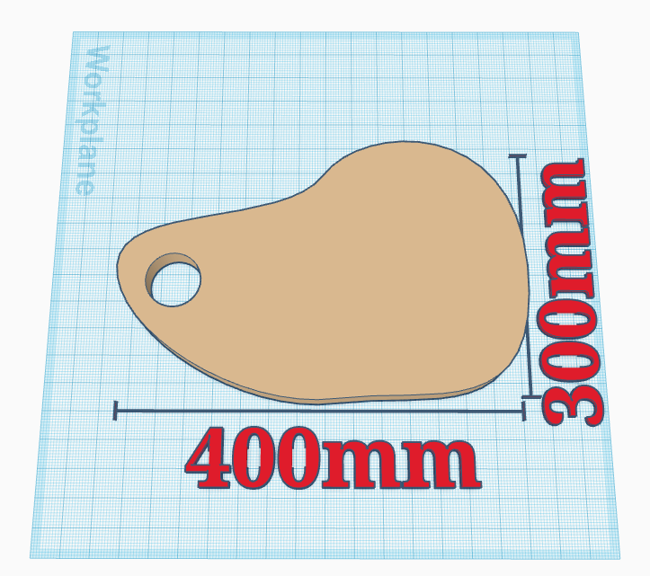

Another question @MitchellMc , and I know its very subjective , what is the recommended size of the rectangular platform for an adult cat?
Re: Looking to design and build a cat tree
Hi @sydneysider,
The hardwood dowel is more than strong enough to support the weight of your cat, even with the cantilevered platforms considered.
I actually thought that if the platforms were a snug fit on the post, they could be left free-spinning. However, after reconsidering, they might shift during a jump, and this wouldn't be optimal. I'd suggest running a single timber screw through the side of the platform and into the post, pinning it in position. This will allow you to easily adjust their positions when needed to keep the route up interesting.
Once the tower is built, you can accessorize to your heart's content. I love the idea of adding a hammock and dangling toys are a must!
A platform around 400 x 300mm should be more than sufficient. You might like to vary their sizes and create some organic shapes for interest. A jigsaw would be perfect for cutting out the curved edges.
