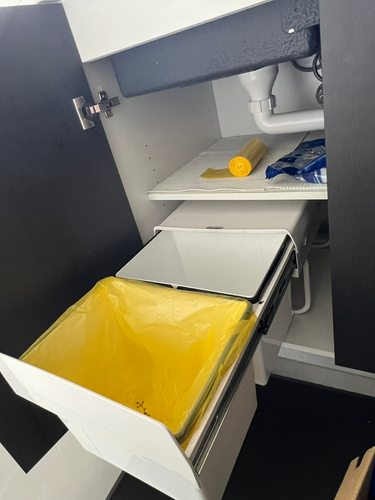

i have single sink (720mm) with cupboard spacing as 900mm in pantry and 600mm sink cupboard in laundry.
so i want to do something like below pullout steel draw and  pullout bins below this sinks
please suggest the product links so i can plan accordingly.  Do these needs to be installed by profession carpenter or DIY?

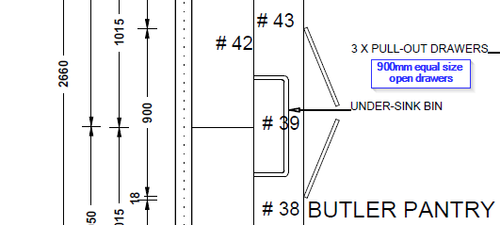

Samara1
Re: Need recommendation for pull-out drawer and bin for under-sink cupboard
great thanks @JacobZ
here is the plan of sink cabinet in pantry:
Hi @Samara1,
The cabinet would need to be modified slightly to install the bin and shelf side-by-side. A divider would need to be installed vertically so that a 450mm shelf and 450mm bin can be used.
