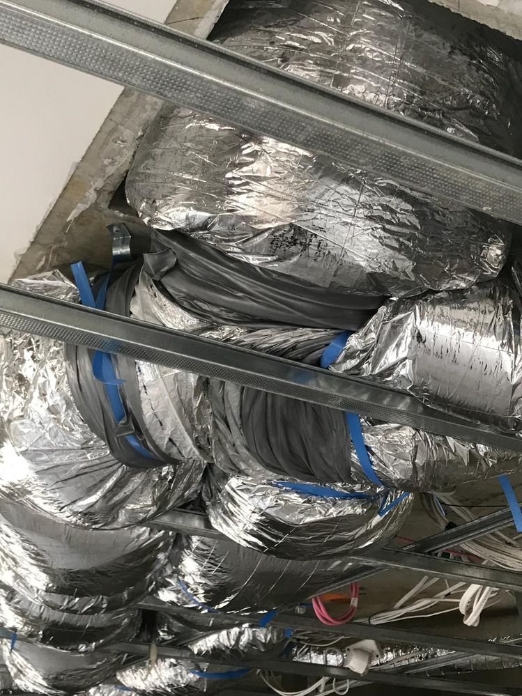

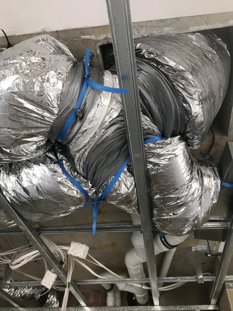

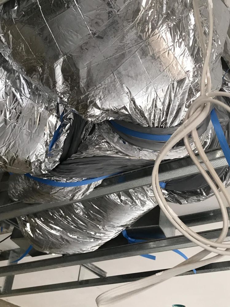

Word of warning re air con ducting.
Once the ducting had been installed, the bulkhead frame was installed to conceal it all. Luckily we caught things before the bulkhead was finished as you can see from the compressed ducting in the pics below. I knew this wasn't ideal and would affect performance so I immediately got onto the builder and AC company so they could investigate and remedy. Managed to meet the AC guy on site with the ceiling guys and agreed to have a solid junction installed to replace the compressed ducting rather than increasing the size of the bulkhead to better accommodate.
I guess the "warning" part of it is moreso the fact, when I first raised this, the response was "Oh no, it should be fine. The guys know what they're doing." The problem is, "the guys" installing the bulkhead aren't AC specialists. So if they don't know what to look for, they won't realise the detrimental effect of their work. I feel it's common sense, but apparently not. So, as always, don't take "No" for an answer from your builder because they'll always try to avoid rework and cost, but you'll be the one that has to live with the subpar AC you've just paid $17k for.

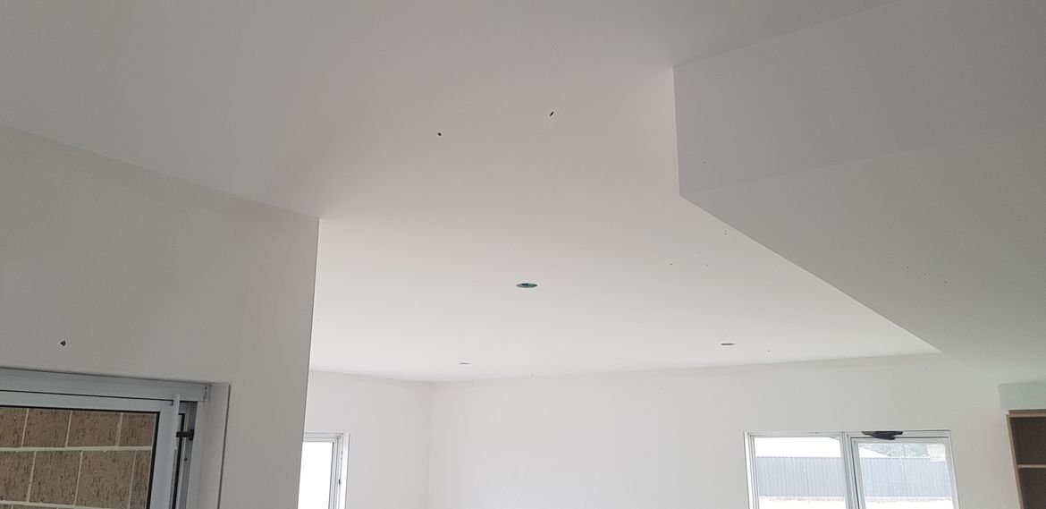

We're stoked with our square set ceilings to Ground floor (no cornices) to give a cleaner and more luxury look as well as giving our already raised ceilings more height. I thought I have pics but don't so will upload some when i get them. For us, this was a very worthwhile upgrade (cost).

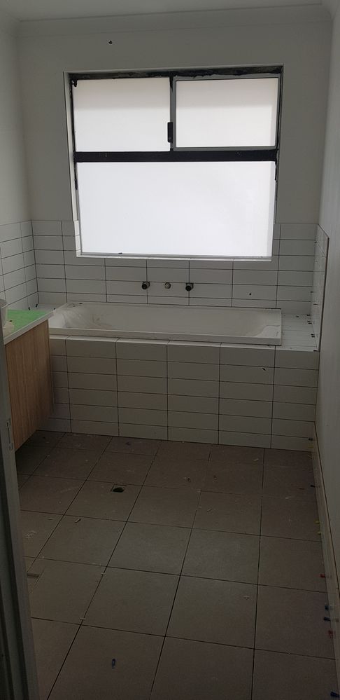

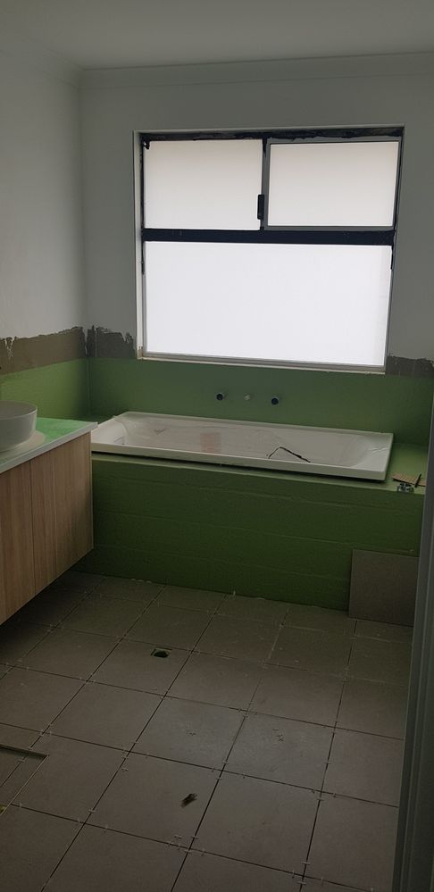

The tiler has been in over the past week and will have it all grouted in the coming days. The tiling is finished (don't have updated pics yet).

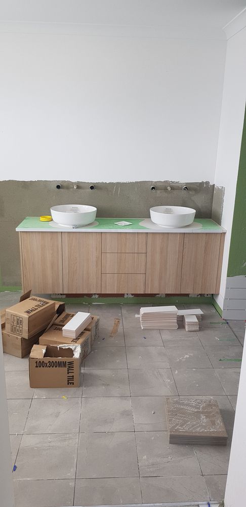

Ensuite double vanity

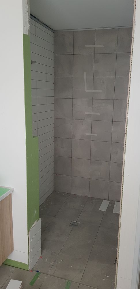

Ensuite shower with feature wall
Ensuite freestanding bath area

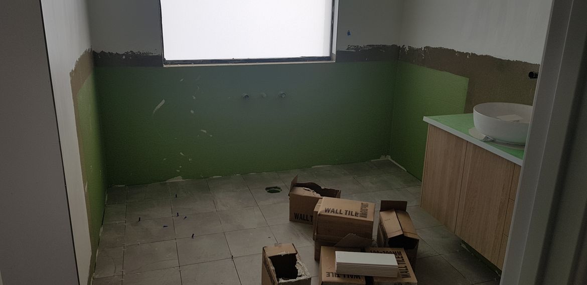

Kid's bathroom
Powder room

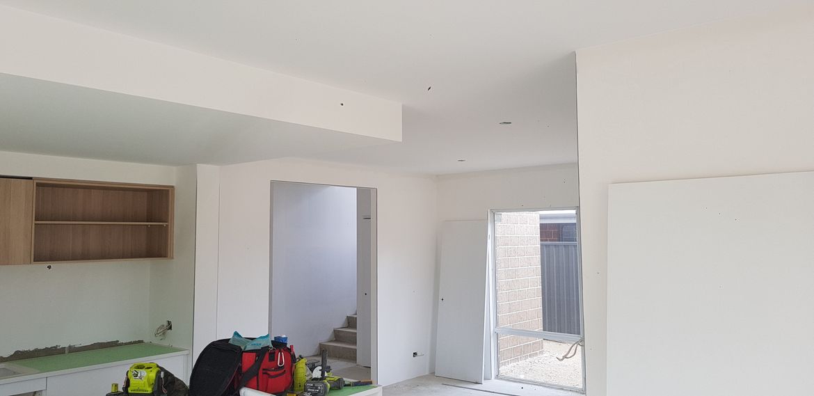

Square set

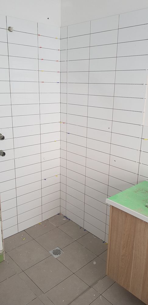

Tiles (pending grout)
Kid's bath
Kid's shower

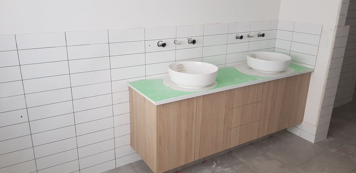

Ensuite vanity
