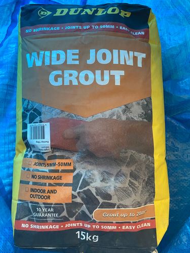

Could you please also assist in suggesting the correct Grout type for 600*600*9.5mm piece tiles. I am using 1.5mm spacers.
I bought the one attached in pic but it is shown for wide joints. Is this OK for grouting 1.5 mm space between porcelain floor tiles?
Thanks again for your advice.
Hello @Sam-Sam
The proudct you have shown is for wide joint grout, it is not suitable for the gap you have mentioned. I suggest using the Dunlop 5kg Flexible Coloured Grout - Slate Grey. This grout is rated for use on gaps between one and eight millimetres. It is safe to use in both indoor and outdoor applications. This grout comes in many colours and some of them come in larger bags.
