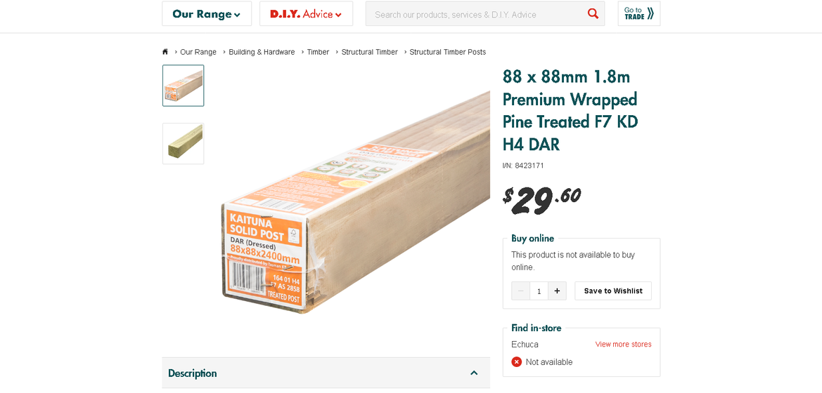

 DAR - Dressed All Round - timber. Dressed timber has been machined on all sides leaving a smooth surface. DAR timber is used for a variety of uses including home renovations, joinery, DIY projects as well as for architecturally-inspired designs such as feature walls and screening.
DAR - Interior use only means that it is not treated and is not meant to be used out in the weather. Usually found inside the store under cover.
DAR - Treated means that it can be used externally and can be used even in extreme weather. Most of these types of timber is usually outside in the timber yard of the store.
DAR Premium - If you are on the Bunnings website it is usually written below in the description if it is for internal or external use. It will also say if it is treated or not as you will see a reference to the "H" rating. H3, H4 as an example. Below is a picture of a DAR premium pine treated. If you tell us what you are planning to build we can give you a better recommendation as to what timber to use.
