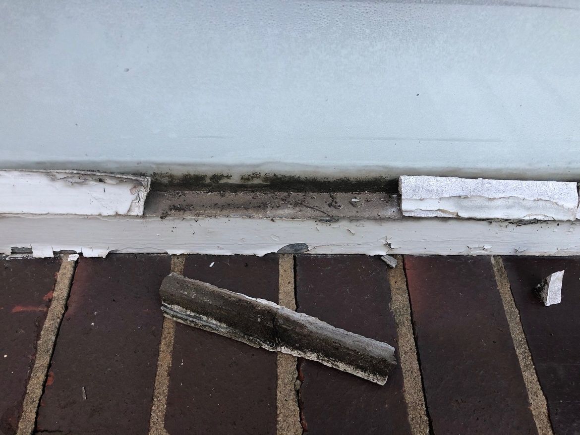

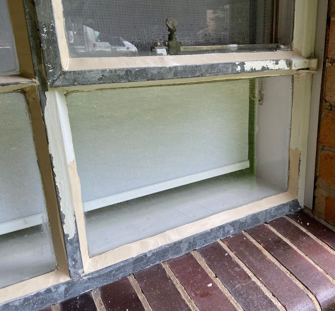

I have old steel frame windows at the front of my brick house and all of the substance that is I assume supposed to be holding the window glass in and finishing it off cosmetically is all crumbling and needs to be replaced.
I have no idea what product to use and how to do it. Can anyone please assist? Obviously it will also need a bit of a clean to get rid of mould etc as you can see from the photo below... And yeah, then we need to get onto repainting the windows, too.
Window and frame with the putty that needs replacing

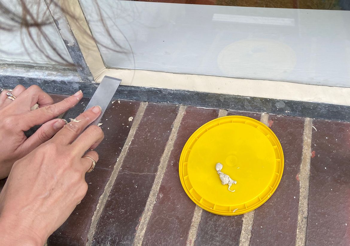

I'm a bit embarrassed, but this project is still on the to-do list! The internal side looks fine and the glass seems to be still firmly held in place, but we do need to do the external. Maybe share some photos of your windows so the Bunnings guys can see yours and suggest what to use.
Huzzah! Good progress finally being made. Now just need to wait for the putty to harden and then re-paint the windows.

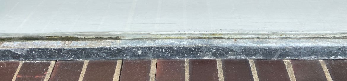

Before:
Old crumbling putty removed:

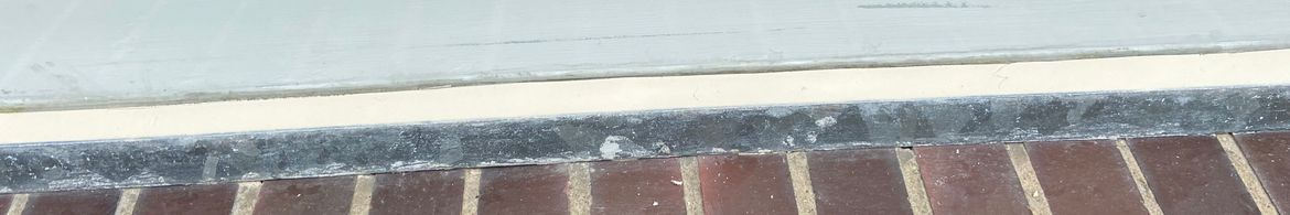

New putty:

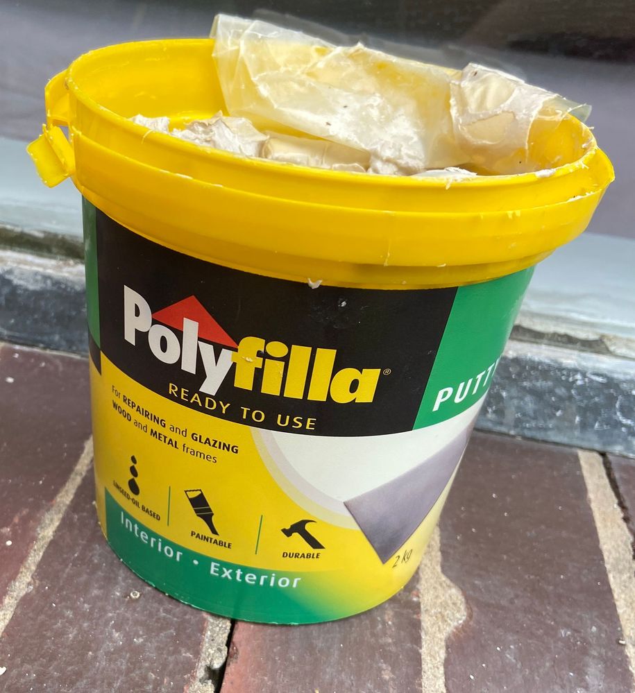

There must be lots of interest in this as the post has had thousands of views! Sorry I told so long to get back to you - it certainly hasn't been too difficult with the putty.

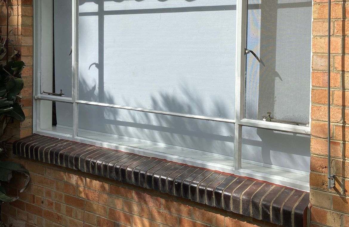

Overdue shot of the finished job after painting.
