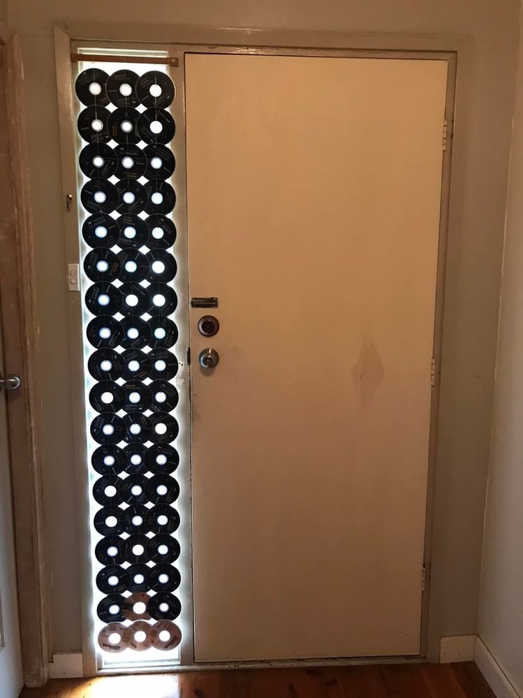

As this was only a narrow opening I screw two large cuphooks into the top of the inside of the window frame. Then measured the distance between the studs and subtracted 10mm for any sideways movement. I unfolded the paperclips to form a giant double hook and then it was a matter of stitching them horizontally and vertically to make a blanket type deal.
I figured that two cup hooks would hold the discs tho they are only single sided.

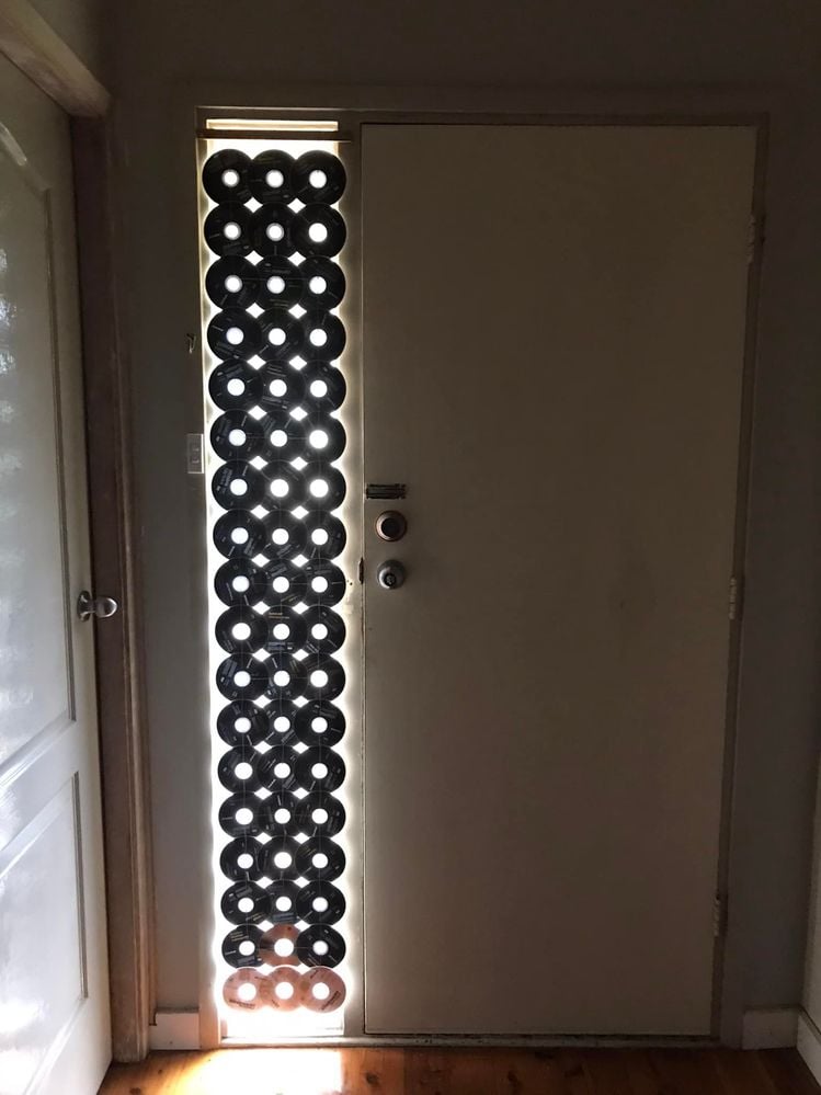

They really start blocking the sunlight. There is also frosted glass for the bit between the door and wall.
With the light on. (Its not a strong light)

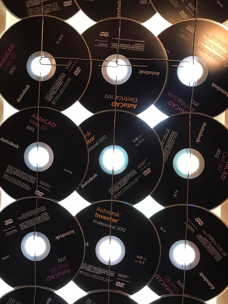

The CD/DVD's are only single sided for this project. I wanted the black on the back to be inside to provide a uniformity and the silver to reflect the sun as much as possible.
Showing how the paperclip is unfolded and how to stitch the discs together, I only stitched every 3rd row horizontally.

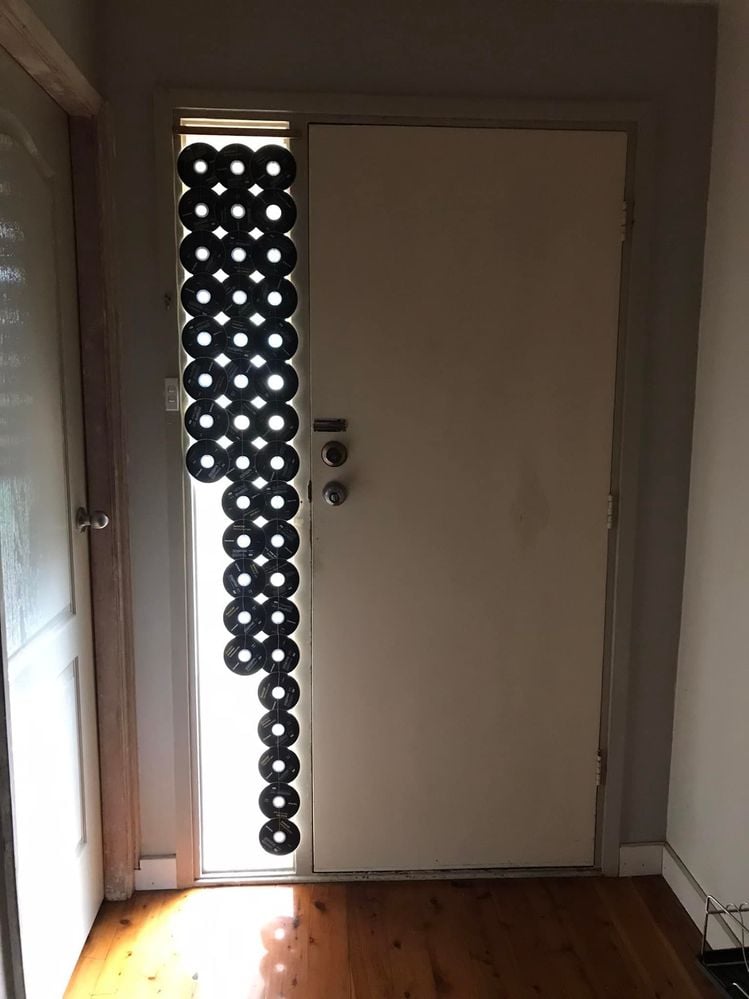

I used an elastic band between two thumbtacks to stop the discs "shuffling about" when the door is open/closed. I will replace this with string or fishing line.
From outside looking in, excuse the paintwork (it is on the list) but really gives a lot more privacy and stops the heat entering the foyer in summer.
