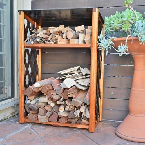

Using a recent project of mine as an example, I will detail the high level stages I went through to turn some old hand railings into a firewood storage.

For my firewood storage rack, I spotted some left over lattice which was starting to rot, so I wanted to include that in the project somehow. My design breakthrough was to use the moulding profile to house the lattice, and use the curved offcuts for the roof.

The lattice is housed between the handrail mouldings
The rounded edge offcuts of the handrails make up the roof,
