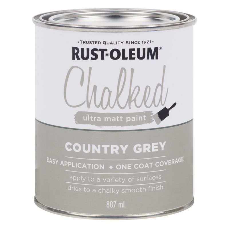

Finally add a coat of Rustoleum chalk paint. I found the best application was with a rag in small amounts. However you can paint it on and sand it back depending on the effect you are going for.Finally add a coat of Rustoleum chalk paint. I found the best application was with a rag in small amounts. However you can paint it on and sand it back depending on the effect you are going for.

                                Rust-Oleum 887ml Country Grey Chalked Ultra Matt Paint
