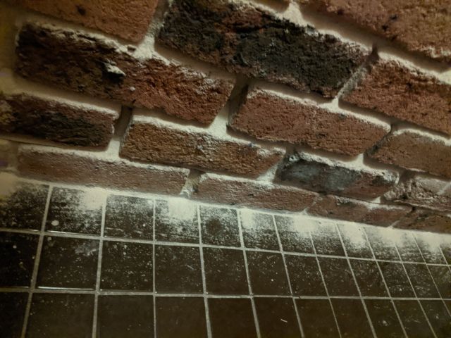

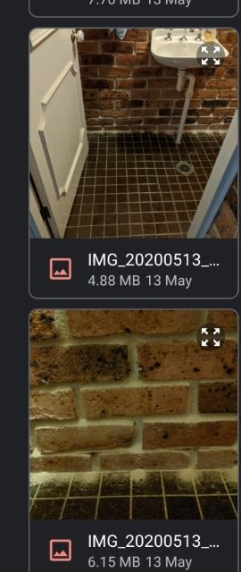

Hi @MitchellMc
I am new here and found this link while searching online.
My toilet wall in garage has that powdery thing coming out of brick wall, house is in good condition and built in 1983-85 and online research shows usage of lime powder etc.
as per your recommendation "remove any mortar that is soft or powdery" : - how much we need to remove as the 5 to 6 bricks from floor few places that powder is falling and the more I touch the more it comes out.
Just want to make sure that I don't take out more than required. Someone else suggested using Frenchman's tool but Bunnings search shows "0" is there a another name for this tool?
Appreciate your help and I have attached the pics in this thread as it seems appropriate.
Welcome to the Bunnings Workshop community @newfast. It's fantastic to have you join us and many thanks for your question.
It appears in your case that you have a complete degradation of the mortar. Is any of the mortar in that wall solid? Check with a steel tool on the bricks above and see if you can dig it out easily. If you can continue to dig out a powdery mortar and there is no sound layer, then I would encourage you to have a professional assess the wall. My concern is that the structural integrity of the wall is compromised and that this is more than just a simple filling repair job.
A Frenchman's tool is just a pointing tool similar to a mortar jointer.
Please let me know if you have questions.
