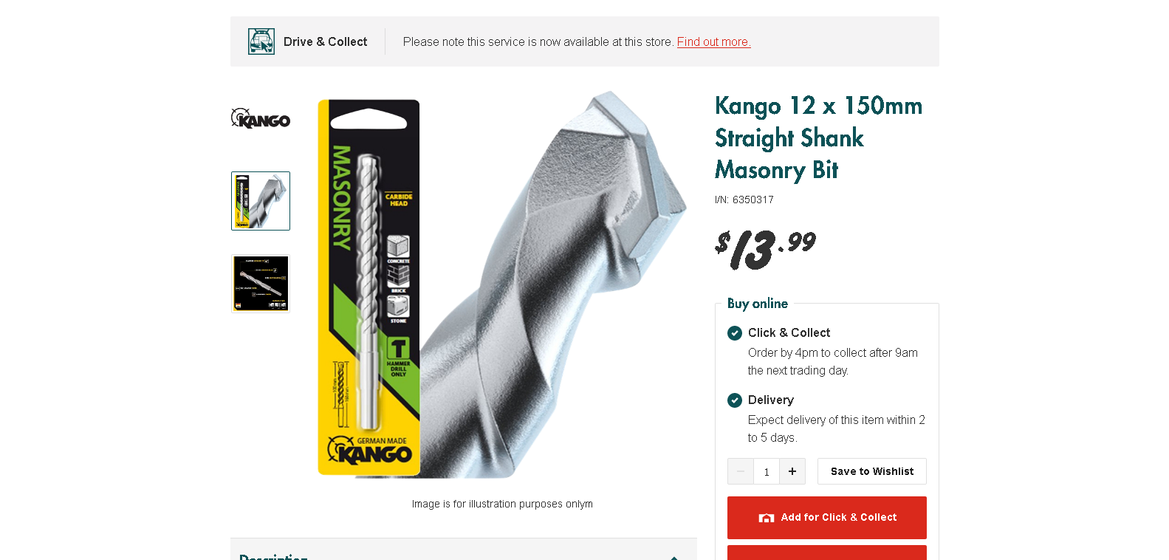

Just to add to @MitchellMc 's excellent recommendation please don't forget to grab a Kango 12 x 150mm Straight Shank Masonry Bit https://www.bunnings.com.au/kango-12-x-150mm-straight-shank-masonry-bit_p6350317 to drill in to the concrete. Just a reminder to set your drill to hammer function so that you don't burn out the drill bit head. Slow and steady wins the race on this exercise. Good luck and stay safe.
