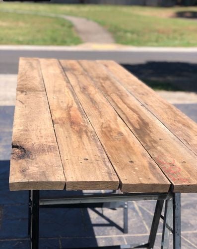

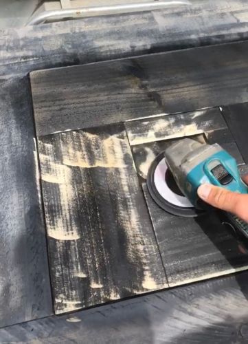

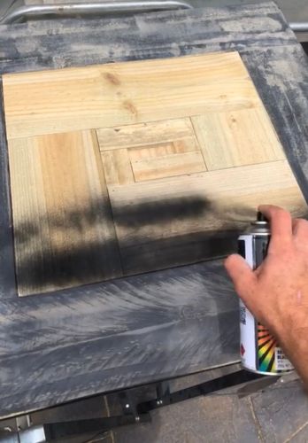

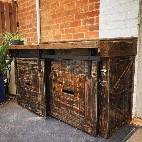

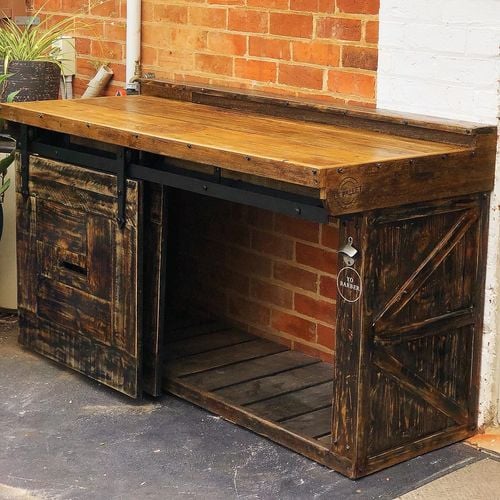

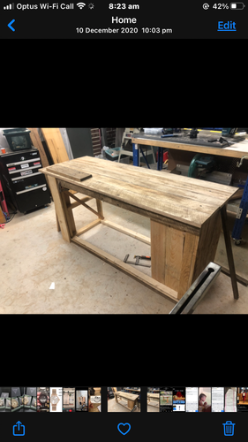

Here I have created my own rustic feature effect on the timber making it look distressed.
This whole build was made from recycled pallets, hardwood planks and treated pine fence palings.
The main feature is the barn style sliding doors on a  double railing system.
The doors are made from 12mm treated pine fence palings glued to a 17mm plywood panel.
Here are some progress photos and a glimpse on how I made the rustic effect.

That's a really impressive aged look you've achieved there @LePallet. I'm a huge fan of the distressed finish and feel it suits this table extremely well.
Many thanks for sharing, and I look forward to your next project.
