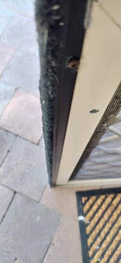

Hi there,
I am trying to replace these door brushes for my security door (sliding) (pic1), but I couldn't find any compatible size to replace with? I tried with one of these bunnings(https://www.bunnings.com.au/moroday-mds4-brush-white-door-seal_p4066812), but there are too big to replace with this one.
Is there any replacement product available for this kind?
TIA

Sliding security doors have a specific type of brush seal. Readily available brush seals are designed for the bottom of entry doors and typically will have a longer brush section. I've found a few types that might suit your needs on the Raven website. This RP2b looks reasonably close and can be ordered through your local Bunnings store's Special Orders counter. However, although the bristles might be the correct length, the thickness of them will be off. Security door seals have a high bristle count and are quite thick as they compress against a flat surface. Door seals are thin as they wipe across the ground and aren't designed to compress.
I'd suggest you'll be after a brush seal specifically designed for a security door, and I'm unaware of any products that match that description. The seal will also likely be specific to that brand of door. Any indication on the door of the brand?

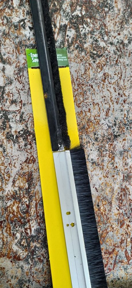

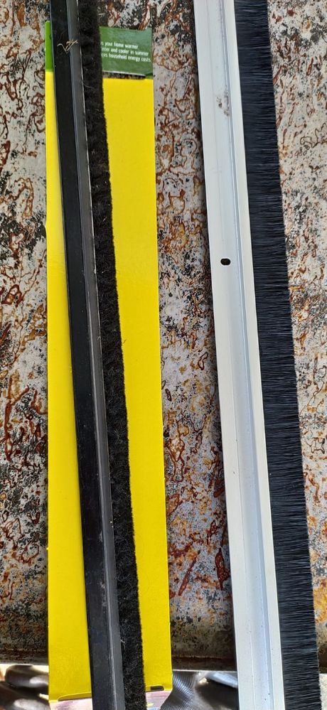

Hi @EricL, It was MDS5 and neither holes were in the correct place nor the bristles were in the correct length. I almost attempted to drill new holes and thought of trimming the bristles, but that didn't look clean.

Thank you for posting the photos of your old and new seal together. If you wish to trim the brush on the MDS5, I suggest using an aluminium or steel rule as a guide. To get a straight cut, clamp the guide to the brush at the height you want to cut. Fix the brush assembly to a table to make sure it does not move.
Instead of using scissors, I recommend using a craft knife with a fresh edge on it.  Run the sharp edge of the knife over the clamped brush in a firm fashion. The straight edge of the ruler will guide your craft knife giving you a straight cut.
In order to prevent drill bit drifting, I suggest using a sharp nail and hammer to make a dimple in the aluminium. This will serve as a guide for the drill bit, and you will be able to make a clean-cut hole.
