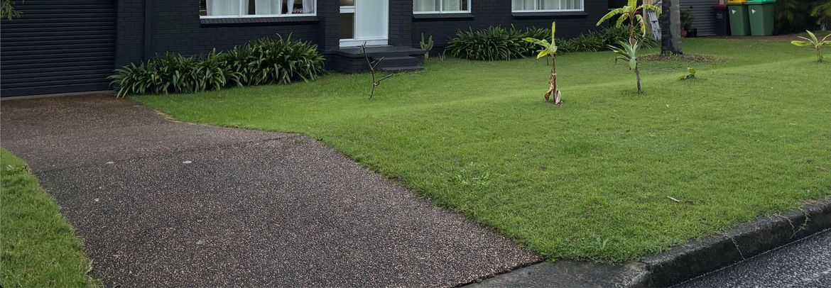

I've started planning my drainage project and wanted some advice. We have lawn and some small shrubs in our front yard. The footings of our house are about 75cm - 100cm lower than the street level. We have a pebblecrete driveway that leads to our garage. The garage is built on a concrete slab that is adjacent to the main house. The main house is on piers that elevated above the ground.
1. Should I cut a channel through the pebblecrete driveway for drainage all the way across the front of our house or is it OK to have drainage in front of the main house and not the driveway?
2. How far from the house does the drainage need to be?
Please let me know if there are any other products that I would need besides the agi-pipe.

If you have some photos of the locations where drainage is an issue, this will greatly help us understand what you are working with. Can I trouble you to upload some photos showing where the main areas you are having issues are?
It would be tough to say whether you need to add drainage across the driveway without seeing it, but a drainage channel that spans the driveway could certainly be worthwhile.
Generally speaking, underground drainage should be at least 600mm from the house, but the specifics of your issue could change this.
For french drains, you will need drainage gravel and geotextile mat. The trench is lined with geotextile mat and drainage gravel, with the agi pipe running through the middle. The drainage gravel allows water to drain through the gaps between it, then find its way into the agi pipe to be carried away. The geotextile mat is there to prevent soil from eroding between the gravel, which will block the channels for water to flow through.
Once we can see what you are working with, I am happy to assist further.
Re: Should I put underfloor insulation under the floorboards inside the house or under the house?
Hi @LR,
If you find water flows down the slope of the driveway, hits the door and runs off to the sides, then I would suggest cutting the driveway and adding a grated channel right before the concrete slab for the garage would be a good idea. That will create a collection point which you can then divert into the agiline you'll be running across the front of the house.
